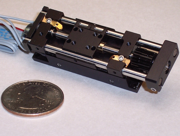

One barrier to both positioning accuracy and speed is backlash. For ultra-high performance applications, National Aperture adds an anti-backlash nut to damp stage motion at the end of run. However, there can be trade-offs. The anti-backlash nut improves accuracy and repeatability but it also adds friction, which means the reduction ratio must be increased to provide more torque. The standard speed of the stages is 6 to 12 mm/s; with the switch to a 64:1 gear-motor, for example, the speed drops to 1.65 mm/s.
Folded microstages such as this one leverage compact encoders and servo motors to yield accurate, repeatable travel in a small package. Photo credit: National Aperture
The anti-backlash nut approach is designed in from the beginning of production, not adjusted on a per part basis. For the damping mechanism to be effective, the motors need to be consistent device-to-device, especially in velocity and torque. The anti-backlash nut comes after the motor and the gearhead, so if the motors are not consistent, then the effect of the anti-backlash nut would vary.
