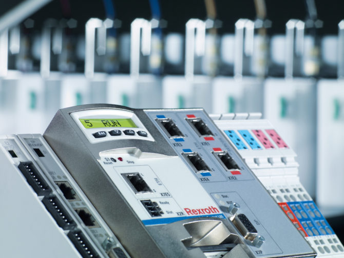

Rexroth’s standard control platforms support the company’s Open Core Interface, which allows the expansion of individual machine functions created with high-level programming languages.
Part of its Open Core Engineering (OCE) framework for PLC automation, Rexroth’s Open Core Interface technology provides a new degree of freedom for mechanical engineering and machine programming. The Open Core Interface allows for high-level language programming with enhanced access to the core of the control system, enabling machine builders to create their own individual functions without the need for additional hardware.
There are often no economical alternatives to standard control systems. As a result, machine manufacturers were previously limited to implementing the same functions available to all other competitors. Rexroth has now done away with this limitation. For the first time machine manufacturers can create individual and real-time machine functions outside of the PLC program with Rexroth’s Open Core Interface technology.
The standard Rexroth control platforms IndraLogic XLC (PLC), IndraMotion MLC (motion-logic) and IndraMotion MTX (CNC) support the direct implementation of individual high-level language programs into the control system. The programs have direct access to the firmware, enabling machine manufacturers to create control algorithms for complex functions and kinematics quickly and independently. The programmers do not require any PLC skills and can use standard high-level languages such as C/C++ instead.
Rexroth also provides machine manufacturers with an extensive library that programmers can use to directly access the control function when developing individual functions. This enables them to directly control axes without writing a single line of a PLC program. Using Open Core Interface is therefore the ideal way to protect the machine manufacturers’ expertise.
