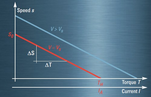

When the motor voltage is constant, the shaft speed decreases linearly as the load increases.  Higher loads require higher torque and hence higher current.  The only way to maintain speed of a dc motor as the load changes is to vary the voltage. The speed vs. torque line shown in the curve illustrates the relationship between the motor speed, torque, current, and voltage.
When the load increases, so does the required torque and winding current. If the motor voltage is constant, for example V = VN, the speed decreases in a linear fashion. Increasing the voltage will increase the speed, but the slope remains constant for a given motor.
Motor specifications indicate the nominal voltage, VN, which is a reference value, and not the voltage required to run the motor. Since many motor specifications depend on voltage, they are listed at the nominal voltage, so an accurate comparison of specifications can be made. However, the speed vs. torque line should always be considered.

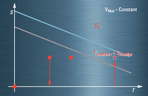

When selecting the winding, first find all the speed-torque points required during every mode of load operation. Especially critical are the extreme points at the end of acceleration when the torque and speed are at their peak values.
VMot is the maximum voltage available from the power supply or battery. Three working points cover all operating conditions. The blue line is the speed vs. torque line of a correctly selected motor and winding. A motor with the gray speed vs. torque line will not have sufficient torque when the maximum speed and torque are needed.
Highlight the maximum voltage available from the battery, power supply, or controller.  Then select the winding that has its speed-torque line located above all normal operating points.
