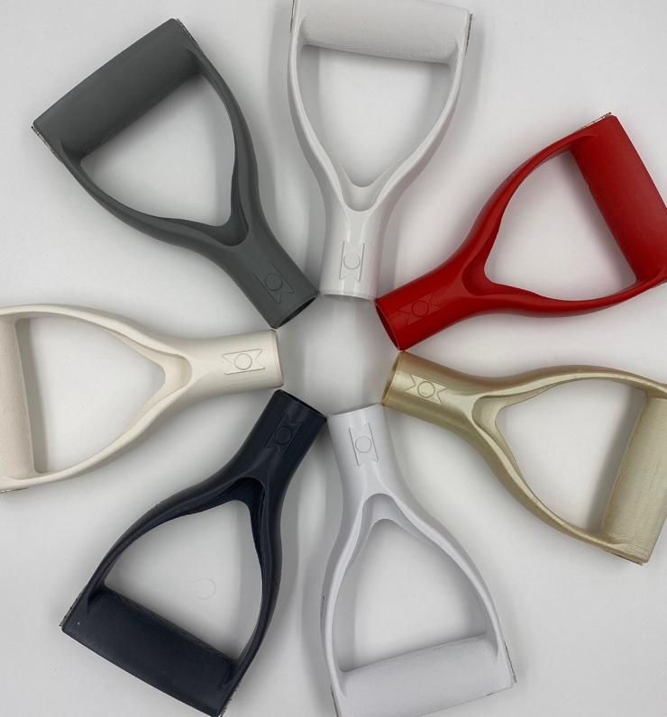

ULTEM 9085 Red, Dream Gray, White, Jana White, Gunship Gray, Aircraft Gray: Providing this flame-retardant, high-performance thermoplastic in several colors opens up more end-use parts applications in which aesthetics are important, such as in aircraft or train car interiors.
PC Red, Black: Polycarbonate filament with heat resistance and high durability for functional prototypes and tooling applications.
PCS-ABS Red: Blend of polycarbonate and ABS polymers provides both heat resistance and flexural strength for a variety of prototyping and end-use parts applications.
