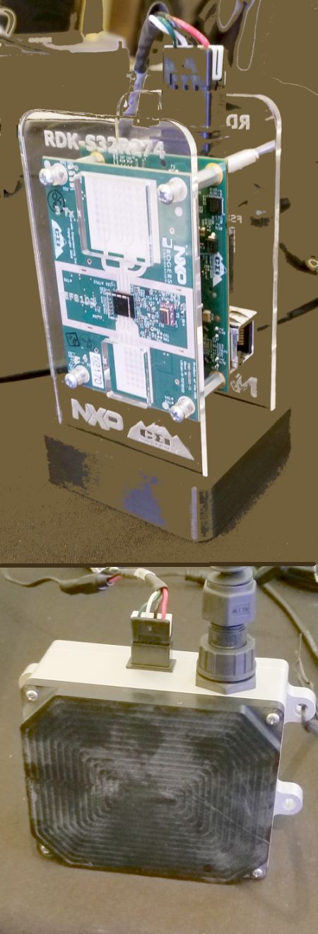

nxp radar module
Automotive radar today often takes the form of a module containing an RF board and a signal processing board. An example is the RDK-S32R274 module from NXP. It typically serves as a radar development platform but can also be used as-is for such tasks as collision avoidance, adaptive cruise control, and occupancy detection. Visible here is the TEF8102 RFCMOS transceiver and antenna arrays. An S32R27 microcontroller and FS8410 Power Management IC sit on the board mounted behind the RF section. Maximum range is said to be 180 m with a range accuracy of 0.175 m. Angular resolution is said to be 4.25° ±0.25°. Bottom, an enclosed automotive radar module with its antenna toward the camera.

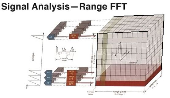

The usual technique is to emit several fast chirps, i.e. a chirp sequence. The resulting data gets put in a data matrix that is often represented as a two-dimensional array, with the detected frequencies of each collected chirp shown in a single column.
Auto radars typically use their signal processor to separate the Doppler frequencies from the range frequencies. The usual technique is to emit several fast chirps, then put the resulting echo data in a matrix that is often represented as a two-dimensional array, with the detected frequencies of each collected chirp shown in a single column. The contents of the columns are generally dubbed “fast time” whereas the contents of the rows are called “slow time.” An FFT performed on the fast-time entries followed by an FFT on the slow-time data gives a speed and a range for one or more targets. Automotive applications also need to resolve targets in terms of their angular position from the radar sensor. To do so, radars generally employ between four and 16 antennas. A fast and slow-time FFT takes place on each antenna output. The resulting data is often visualized as a cube with X and Y axes composed of the fast and slow-time data and a Z axis representing the data for each of the antennas. Effectively, this cube represents a 3D map with axes of speed, distance, and azimuth.
The contents of the columns are generally dubbed “fast time” whereas the contents of the rows are called “slow time.” Chirp-sequence signal processing starts with an FFT performed on the fast-time entries followed by an FFT on the slow-time data. An FFT along the fast time axis effectively provides what’s called a range compression because it compresses all the reflected energy into a range. Similarly, the second FFT along the slow-time axis provides a speed compression. In the simple case where there is a single target, get a single peak at the target’s range and velocity.
The two-dimensional FFTs give a speed and a range for one or more targets. The targets are basically peaks above some noise threshold. (The setting of this threshold is a processing problem in and of itself.) But automotive applications also need to resolve targets in terms of their angular position from the radar sensor. To measure this angular position, radars employ multiple antennas, generally between four and 16. A fast and slow-time FFT takes place on each antenna output. The resulting data is often visualized as a cube with X and Y axes composed of the fast and slow-time data and a Z axis representing the data for each of the antennas. Effectively, this cube represents a 3D map with axes of speed, distance, and azimuth.
