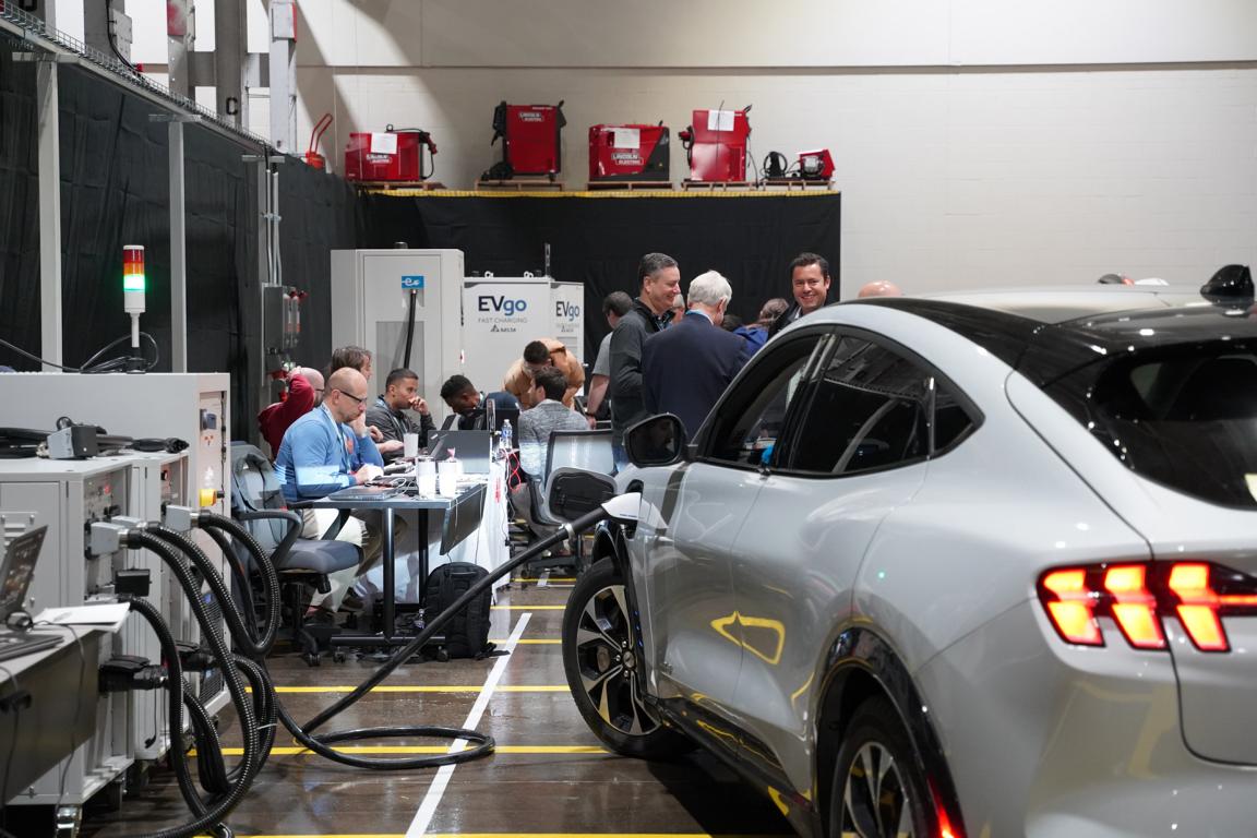

One possible domestic solution may be hiding in a surprising place. Recently, I attended an event called a Testival, hosted by Lincoln Electric in Cleveland. Testivals are conducted by CharIN, a global non-profit seeking to bring the automotive industry together to create consensus on charging standards and best practices. Here, engineers discuss not just things like power, but other equally important issues such as data, billing, and privacy. When you take your EV to a new charging station, how does the charger know the vehicle’s not stolen? How does it share your credit card information to complete the transaction? How does it know if the electrical connection is safe and secure? Many of these issues must be discussed and refined and tested before rolling them out to the general public. And there are a lot more EVs to come in the next few years.
Copyright CharIN Testival NORTH AMERICA 2023.
“If you think about today’s market [probably] less than 1% of the electric vehicles that will be sold are sold; 99% of electric vehicles haven’t been sold yet. What we’re doing here at these Testival events helps ensure that any charger from any company can work reliably and seamlessly with any vehicle from any company,” said Oleg Logvinov, Chair of CharIN North America and President and CEO of IoTecha Corp.

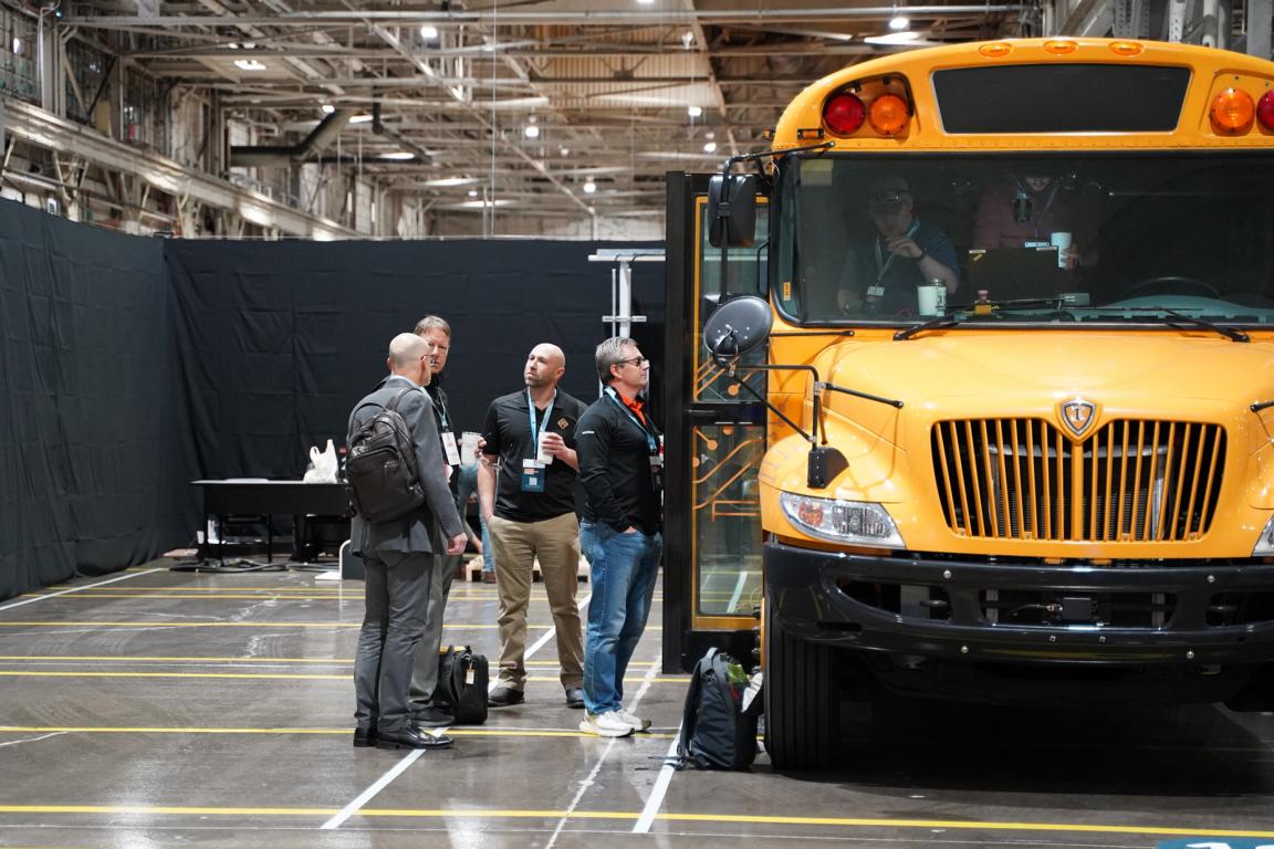

Logvinov points to fleets of school buses in the U.S. as a potential storage solution. School buses are perfect candidates for enabling bidirectionality because they run in the mornings and the afternoons. The rest of the time they tend to be stationary. They have fairly predictable routes and usage patterns (even with the occasional school trip or away football game). What’s more, they generally sit still for most of summer.
“Imagine that you have even a 100-kilowatt hour battery, but you have thousands of them,” said Logvinov. “It’s a huge energy storage opportunity — all of a sudden, we have the ability to take energy we are getting from wind and solar, store it there and when necessary, and release it back. All of a sudden, we solve one of the greatest problems that we’re facing today.”
