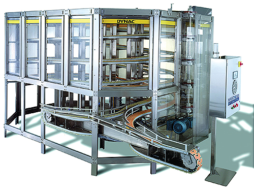

This industrial machine is an example of a design where throughput is a higher priority than accuracy or absolute precision for the application.

Speed or part throughput is a top priority in any machine design. But is it exclusively the top priority, or are there other constraints that must be balanced with throughput? A prioritized framework of metrics clarifies the project objectives and improves decision-making. Based on the priorities of Case 1, for example, it might be more valuable to the project to spend time in reducing the cost of the machinery instead of spending more money on precision feedback. In the priorities of Case 2, the cost of the machine and the development of the machine are less important than achieving the precision requirement and part throughput.
hartness-machine
While performance metrics help quantify design features, valuable information is gained when these features are prioritized by their importance to the customer, design goal, or cost.
