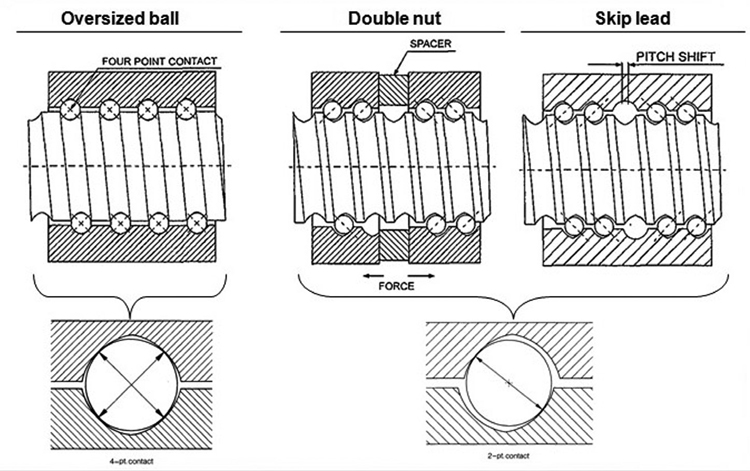

A non-preloaded ball nut has internal clearances between components, meaning that backlash exists. A preloaded ball nut has no axial clearance and therefore eliminates backlash and subsequently increases stiffness. Preload also increases the torque required to turn the screw and is measured by the percentage of preload to dynamic capacity (a ball nut with a dynamic capacity of 1500 lb and a preload rating of 10% has a 150 lb internal preload). Precision thread ball screws are generally used without pre-load. Pre-loading a ball screw improves repeatability by removing backlash, but does not affect accuracy.
Preloaded ball nuts are available on precision plus screws and select precision screw products. Their cost is higher than non-preloaded nuts due to complexity, additional machining, assembly, and verification/measurement. Ball screw assemblies can be preloaded with double or single nut configurations. There are three major types of preload – single nut oversized ball (4 point contact), single nut skip lead (2 point contact) and double nut (2 point contact). Single nut preload maintains the smallest package size while maintaining full load capacity. Skip lead ball nuts have half the capacity of similar sized single nuts as only half the ball bearings are loaded in each direction. Double nut preload assemblies have the same load capacity as a single nut as only one ball nut is loaded in each direction.
