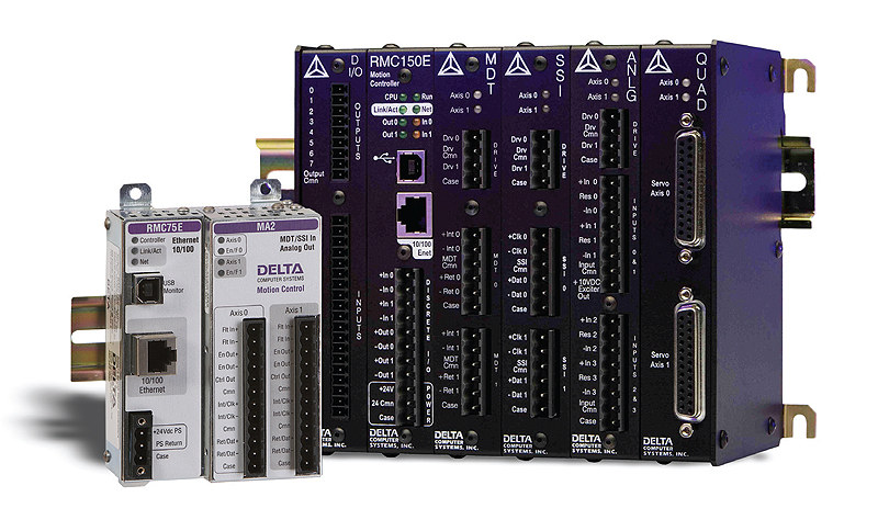

Delta-Computer-Systems-motion-controllers
Motion controllers, such as the RMC75 and RMC150 controllers by Delta Computer Systems, provide direct interfaces to transducers and proportional valves to simplify system integration.

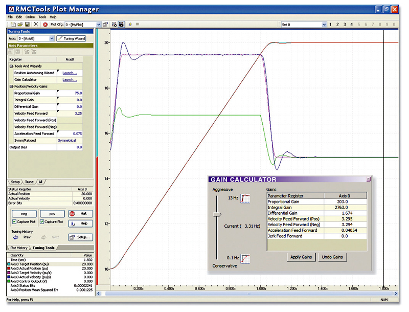

A programmable motion controller designed to precisely control applied force and transition smoothly from position control to force control is an essential part of an electric hydraulic control system. Machines can be adapted automatically to deal with different material consistencies and the effects of differing environmental conditions such as temperature and humidity. Also, more flexible production results from the ability to easily change a ‘recipe’ that changes positions and forces specified during the machine cycle. Machine downtime for production changeovers can be significantly reduced. Further, target positions and forces can be changed “on-the-fly,” allowing more flexibility in making more challenging parts.
More consistent, smooth motion also results in less wasted or rejected parts, and ensures consistent production output quality from different machine operators with widely varying skill levels. By automatically coordinating the motion of multiple axes, you can scale machine performance, improving productivity at the high end, while facilitating troubleshooting at slower speeds.
Delta-Computer-Systems-RMCTools-Plot-Manager-software
A motion plot produced by Delta Computer Systems RMCTools Plot Manager software. The red curve indicates axis position, the blue curve axis velocity, and the green is the drive level being provided to the proportional valve.
