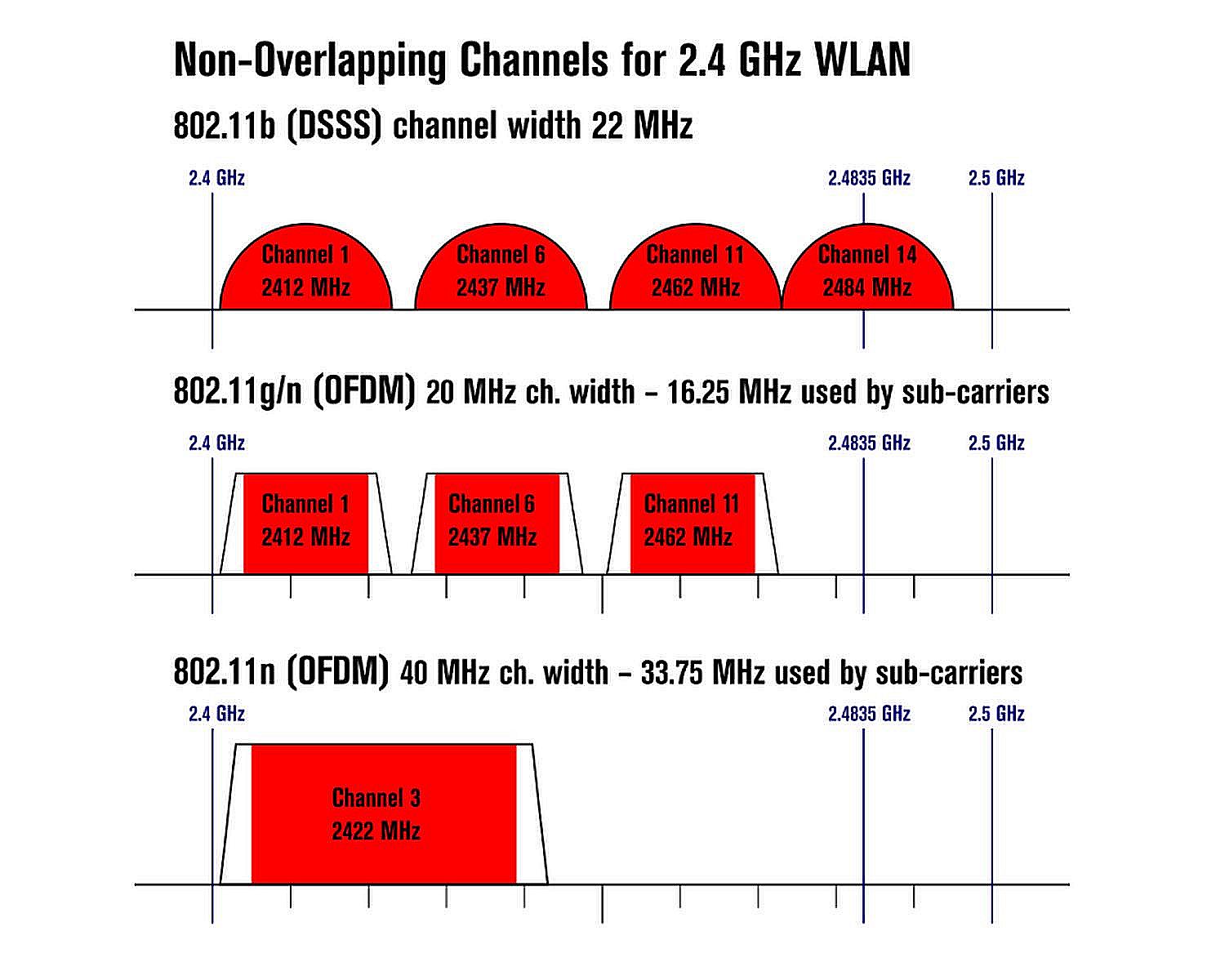

We live in a world with an increasingly crowded radio frequency spectrum that is only likely to become more stuffed with RF signals. This is particularly true for the frequencies within the ISM spectrum bands originally reserved for industrial, scientific, and medical purposes. Now, of course, this part of the spectrum is employed by WiFi, Bluetooth, and numerous other emerging communication schemes. These systems are clustered around 2.4 GHz, but other bands are packed with signal sources as well. For example, LTE cellular operates with carrier frequencies typically below 2 GHz, while direct-broadcast satellites have a 12-GHz downlink and a 17-GHz uplink.

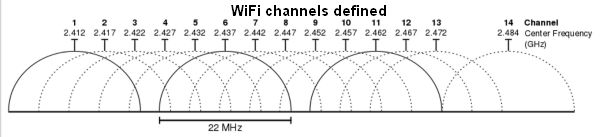

Co-channel interference comes from another radio operating within the same wireless system. For example, cellular base stations will transmit on the same frequency channel when the base stations physically sit far apart. But occasionally the signal from one base station reaches a neighboring cell area. To the second base station, this signal is co-channel interference. Wireless LAN networks can also experience co-channel interference when two radios transmit simultaneously and collide in the same frequency channel. WLANs try to minimize this possibility by having WLAN transmitters listen for an open channel before transmitting, but there is a potential for simultaneous transmissions nevertheless.
Co-channel interference is one of the most common types of radio interference because large numbers of wireless users occupy relatively few frequency channels. The usual way of observing co-channel interference is to shut off the transmitter of interest and tune a spectrum analyzer to the appropriate frequency channel.
Out-of-band interference originates from a wireless system that — due to improper filtering, non-linearity and/or signal leakage — also transmits energy in a frequency band outside that of its intended use. An example is when a poorly designed or poorly filtered transmitter radiates harmonics that fall into a higher frequency band.
The measurement of harmonic levels generally takes place using a spectrum analyzer with a frequency range of at least three times the fundamental of the harmonics. For example, consider the case of verifying the performance of a transmitter operating at 802.11b channel 14, 2.4835 GHz. The second and third harmonics are at 4.967 and 7.4505 GHz, respectively. The measuring instrument must have a bandwidth exceeding about 7.5 GHz to see these harmonics.
Adjacent channel interference results when a transmission at the desired frequency channel produces unwanted energy in other nearby channels. This type of interference is common and primarily created by energy splatter out of the assigned frequency channel and into the surrounding upper and lower channels. Energy splatter (also called switch noise) refers to spurious emissions resulting from an abrupt change in the transmitted signal, usually when transmission starts or stops. It can also be generated by modulation and intermodulation distortion.
