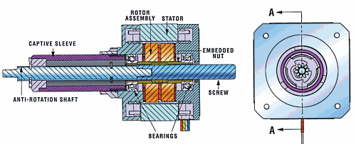

For the linear actuator that uses a screw, precision depends on the thread pitch. Inside a linear actuator, a nut is located in the center of the rotor. The screw engages this nut. For the screw to move axially, it must be constrained from rotating with the nut and rotor assembly by some means. By inhibiting screw rotation, linear motion is achieved as the rotor turns. Such anti-rotation is typically carried out either internally with a captive shaft screw assembly or externally with a nut on the screw shaft that is prevented from rotation, yet free to move along its axis.

Figure 1. One way to convert rotary motion into linear is through a leadscrew and nut assembly inside the motor. This approach lets you use a “drop in motor” in your designs, eliminating the need for external mechanical linkages. This schematic shows the insides of such a motor.
For simplicity, it makes sense to achieve rotary to linear conversion inside the motor. This approach simplifies the design of many applications by allowing a “drop in motor” capable of precise linear motion without the need to install external mechanical linkages (Figure 1).

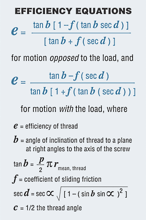

Assuming friction, torque and lead angle are the same; a “V” thread will deliver approximately 85% of the force of an Acme. The efficiency is determined using one of the following equations for use with threads having a V shape, dependent of load direction. The ratio is simply calculated by dividing the efficiency of the 60° threads by the 29° threads.
The efficiency calculations do not take into consideration that the surface pressure will be higher on the “V” thread, further increasing losses.

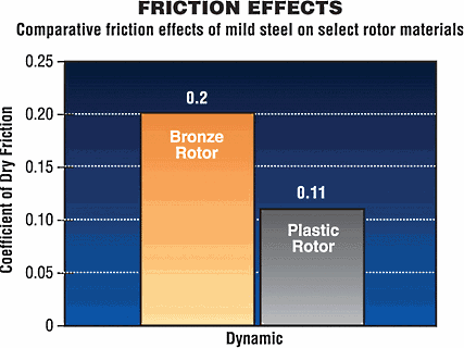

friction effects on rotor materials
Figure 3. Nuts made from newer engineered plastics enable screw threads to travel with a lower coefficient of friction.
A better material is a lubricated thermoplastic material. With the new engineered plastics, screw threads may now travel with a lower coefficient of friction. Figure 3 contrasts the rotor thread materials’ frictional properties.
Based on this, it would seem obvious; why not use a plastic drive nut? Unfortunately, as good as the plastic is for the threads, it is not a stable enough material for the rotor journals of a hybrid motor. With motor temperature potentially rising to 167° F during operation, the plastic in this case could expand as much as 0.004 in. Brass, on the other hand, may only expand 0.001 in. under the same thermal conditions (Figure 4).
