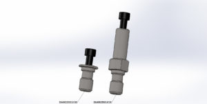

IMG_1442
These pull bolts fully incorporate Mazak’s specifications and are uniquely manufactured to implement JMPP’s patented High Torque retention knob standards from 9310H material.
Coupling bolts used for live tooling on lathes are subject to relaxation, which occurs due to inadequate pre-loading of the bolts during installation, or to rough or inaccurately machined coupling faces — resulting in misalignment. This misalignment causes excessive vibration, which puts an unnecessary load on bearings, and curtails operation at full power.

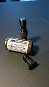

IMG_1453
By implementing their patented high torque retention knob design into coupling bolts for live tooling in Mazak’s multi-tasking machining center lathe workpieces, JMPP provides machine distributors several competitive advantages.
