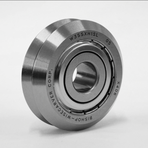

Bishop-Wisecarver-LEAP Award-winner-product-imageGOLD
Bishop-Wisecarver
Solid Lubricant DualVee Guide Wheels
What the judges had to say: “A new technology for lubrication that can impact a wide range of applications. Plus, 2.5 times longer life expectancy is exceptional for a bearing!”
DualVee® guide wheels are known for their ability to excel in harsh and extreme environments. The new solid lubricant wheel offers even greater life and ingress protection than ever before seen in guide wheel motion systems. In most applications, this guide wheel will last several times longer than guide wheels of a similar size and capacity.
Instead of using a grease to retain the oil for lubricating the internal bearings, this wheel uses an oil-impregnated solid polymer matrix. This matrix improves the environmental resistance of the internal elements and keeps the bearings running well-lubricated for longer. Plus, it retains the vee wheel geometry of DualVee® guide wheels. This means the matching 90° angles in the wheel and track generate a self-cleaning wiping action that clears away debris as the wheel rolls.
DualVee Solid Lubricant provides smooth and quiet motion over any length, with the highest degree of protection and longest wheel life of its kind.

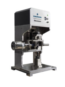

GMX-HP_external2_1BRONZE
Emerson
Branson GMX-HP
The Branson GMX-HP ultrasonic metal welder is a new member of Branson’s GMX ultrasonic metal welding product portfolio. The GMX-HP delivers higher power with greater downforce, essential for larger welds like electric vehicles, batteries, and energy storage systems. The GMX-HP features increased weld power, furnished by a high-capacity, 8-kilowatt,
20-kilohertz power supply. Welding power is transmitted through a direct-press actuator, equipped with dual linear bearing guides, precision distance sensors, and a dynamic pressure trigger that delivers greater part-holding downforce with the high stability needed for repeatable weld quality.
