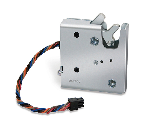

Replacing traditional key locks, electromechanical locks and latches (EMLs) are the heart of Electronic Access Solutions (EAS). These devices enable quick access to medical equipment while meeting increasingly stringent security requirements.
EMLs enable designers to build intelligent security into the products. The electronic lock creates an electronic signature for user authentication, an audit trail, and reporting capabilities. These features simplify security administration and eliminate opportunities for physical security breaches. Tying EMLs into all or part of an existing security system enables real-time monitoring and an audit trail of access activities.
Electronic access solutions provide an indisputable access audit trail for all doors and cabinets that are secured electronically. Each time the EML-equipped enclosure opens or closes, a signal is sent to a monitoring system to confirm and log access. In addition, EAS records which user credential was used to activate the EML, as well as the time and duration of the event. It also allows access records to be viewed remotely, so monitoring personnel need not be onsite.
Once installed inside the equipment, an electronic rotary latch takes up minimal space. Electronic rotary latches can be connected with a variety of electronic access systems for a complete, remotely managed access control system.
