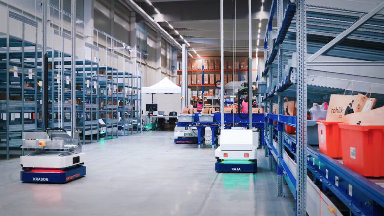

Rohlik installed Brightpick Autopickers in a Prague fulfillment center without changing its process significantly. The robots almost eliminated picking labor and dramatically reduced costs. Image courtesy of Brightpick.

The robotic arm and vacuum gripper picks and consolidates items in the aisles to reduce travel time and increase picking speed. Image courtesy of Brightpick.
Brightpick Autopicker robots are like humans with carts that move around the warehouse, retrieve product storage totes from shelving, and robotically pick items from those totes to consolidate orders directly in the aisles. The robots don’t need to travel back and forth to centralized picking stations. This results in faster picking, and they reliably pick most groceries with 99.9% accuracy. They also include goods-to-person capabilities for items that require human dexterity and autonomously find the nearest human picking station.
