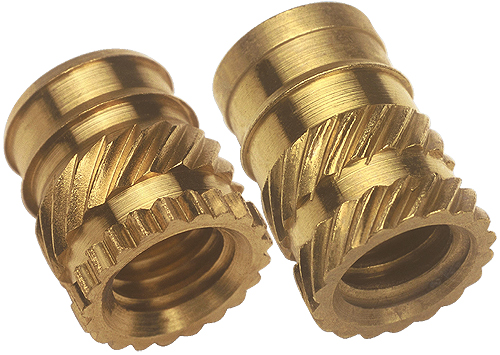

Undercuts, knurls and threads on the outside of an insert help improve its performance.

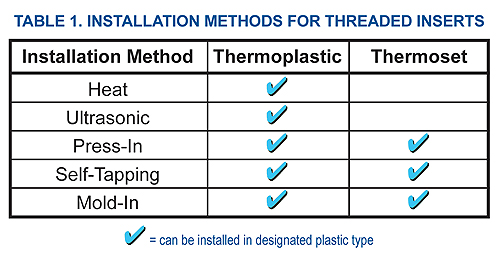

Heat and ultrasonic installation is only used with thermoplastic parts. Thermoplastics are solid at normal temperatures and can be re-melted a number of times, whereas thermoset parts have a one-time reaction in their conversion from liquid to solid and cannot be re-melted.

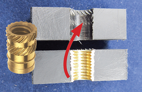

With both heat and ultrasonic installation methods, the insert is embedded into a molded or drilled hole through re-melting of the plastic. The melted plastic conforms to the external features of the insert, ensuring retention within the hole. A sufficient volume of plastic must be displaced to entirely fill these external features to ensure maximum performance when the plastic solidifies. An accurate way to determine sufficient plastic flow into the knurls, barbs and undercuts of an insert is to take a cross section of the installed insert and check that the features are mirrored in the plastic. It is important to ensure proper plastic flow into the features of the insert as this dictates the torque and pullout performance.

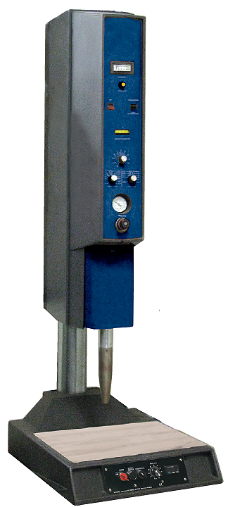

An ultrasonic insertion machine converts electrical power into a mechanical vibratory output. A pneumatic cylinder typically delivers the downward force while an ultrasonic horn delivers mechanical energy to the metal-plastic interface.
Ultrasonic horns (manufactured from various metals including titanium alloys, stainless steel and aluminum alloys) directly contact the metal insert. As the horn vibrates, the mechanical energy is transferred to the plastic surrounding the insert creating the heat and melting necessary for insertion.

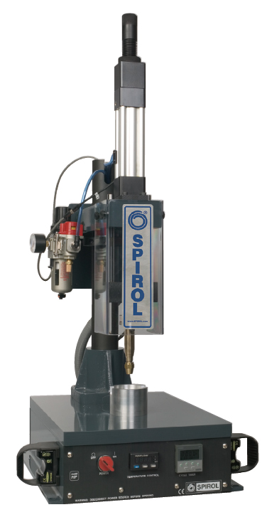

Two methods are available for heat insertion; heat is transferred from the heated tip through the insert to the plastic, or by preheating the inserts and then pressing them in. In both cases, a controlled force is applied to the insert to ensure that the plastic is sufficiently melted before the insert is installed. Since heat installation requires heating the entire insert and not just the metal-plastic interface, the insert material should have excellent thermal conductivity (brass and aluminum are common choices).
Heat installation enables the insert to efficiently transfer heat to the plastic. (It also enables the insert to cool down quickly after installation). Once the plastic reaches its melting temperature, it begins to fill the retention features of the insert and then solidifies while inducing minimal stress.

You can use several methods to install inserts. Installation of inserts after molding (post mold) versus molding-in reduces costs by shortening molding time. Post mold installation also reduces the chance of scrap and potential mold damage resulting from dislodged Inserts. As shown in this table, heat and ultrasonic installation is only used with thermoplastic parts. Thermoplastics are solid at normal temperatures and can be re-melted a number of times, whereas thermosets have a one-time reaction in their conversion from liquid to solid and cannot be re-melted.

An ultrasonic insertion machine converts electrical power into a mechanical vibratory output. The downward force is typically provided by a pneumatic cylinder.

Heat insertion of inserts is accomplished by transfer of heat from the heated tip through the insert to the plastic, or by preheating the inserts and then pressing them in.
