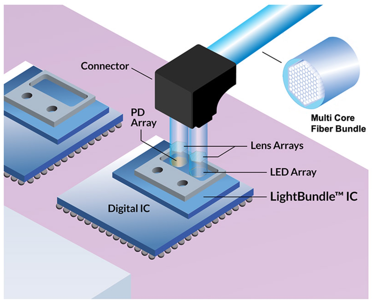

In another example of optical interconnects for chiplets, arrays of micro-LEDs have been 3D stacked onto a CMOS interface IC that bundles silicon detectors. This new optical interconnect architecture enables low-power links with under 1pJ/bit and up to 10m reach. The parallel architecture of the interconnects is designed to match the wide internal bus architectures of devices like CPUs, GPUs, and large ASICs, eliminating the need for power-hungry serialization-deserialization (SerDes) interfaces. It enables the separation of devices like GPUs and high bandwidth memory (HBM), improving the thermal performance of HPC systems (Figure 2).
