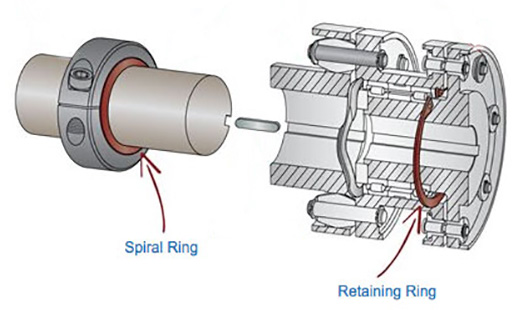

Selecting an appropriate retaining ring for an application typically involves evaluating factors such as installation stress, the radial load exerted by the ring, and the thrust capacity of the ring. And because the groove that holds the ring is integral to the ring’s performance, groove deformation needs to be considered as well.
But when an external retaining ring is used on a rotating shaft, centrifugal forces can cause the ring to lift out of its groove, leading to ring failure, so maximum speed becomes an important selection factor as well.

Spiral retaining rings can have more than one turn, or coil, around the ring’s diameter. Typical constant section and tapered rings have only one turn, so for these designs, the factor for one turn (1.909) is used.

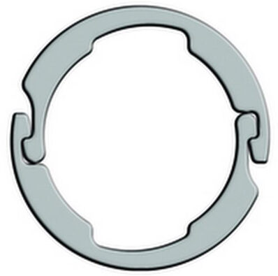

To address applications that run at high speed, retaining ring manufacturers have developed external rings with self-locking features that prevent the ring from failing, even under high centrifugal forces.
One design, used for spiral-wound retaining rings, incorporates a raised dome on the inside turn of the ring and a slot on the outside turn. As speed increases and the ring begins to expand, the dome slides along the slot, and the length of the slot limits the amount by which the ring can expand. Another design, used on traditional retaining rings, features a two-piece ring whose ends interlock when assembled onto a shaft, preventing the ring from expanding.
