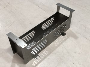

Most laser cutting is done using metals, including aluminum, brass, or cold-rolled steel like in this custom battery case application.
Whether you are an engineer, an entrepreneur, or just a frequent user of prototypes, laser cutting allows the design and manufacture of products with speed and precision — at a low cost.
Even though laser cutting requires a piece to be cut on a flat material such as a sheet of metal, it doesn’t mean users can’t create 3D objects with their design. A range of equipment and other tools have been designed with laser cutters. Manufacturing 3D parts and products is possible with laser cutting with creative thinking, a bit of assembly, and most importantly, some smart design work.
