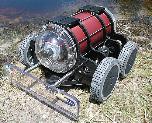

The HullBUG grooms the biofilm that collects on the underwater portion of ships.

“The most important feature of the HullBUG is its small size,” says SeaRobotics’ Research Engineer, Dr. Kenneth Holappa. “It is only about half a meter in length.” This was a necessary design feature to allow the vehicle to maneuver over the curved surface of the hull while continually maintaining close contact with the surface. An additional benefit of the size was that it allowed a single operator to deploy the vehicle without the use of additional equipment such as a crane. Because of the hazards associated with operating such a device underwater and in a harbor environment, occasionally a HullBUG might be lost or destroyed during operation. Keeping the size and cost of the system low definitely helped to eliminate damage as a major obstacle to implementation. So, from the very beginning of the project, small size and low cost have been identified as being critical to the satisfactory implementation of the HullBUG project. As can be expected, this need to maintain a particular size and weight filtered into the selection of every component of the design.

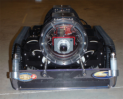

The selection of the motors to drive the HullBUG involved a number of critical engineering constraints and compromises. SeaRobotics decided to make two basic models, one with wheels and one with tracks, and offer several options for monitoring the system’s progress.
This close-up of the HullBUG clearly shows its sensor alignment system that helps it keep on course while cleaning a hull.
Motor sizing, for example, required a calculated estimate of the power, speed, and torque characteristics of the manufactured devices. Determining factors included the resistance caused from pushing the grooming tool across the surface of the ship, the hydrodynamic resistance of the vehicle itself as it moved through the water, friction losses in the shaft seals that were used to protect the motors from the saltwater, and track or wheel friction dependent on which version of the unit was used.
“After extensive component research, we chose to use Maxon motors and gearheads,” says Holappa. “Their motors not only provided a very cost effective solution, but they were highly efficient and extremely simple to implement.” The company used EC flat motors with planetary gearheads. Two motors were used on the tracked version of the HullBUG (one for each track); while four flat motors were needed for the wheeled version (one for each wheel). An additional EC flat motor was implemented in the grooming tool. That motor used a simple spur gear for speed reduction. In addition, a final motor, connected directly, was used for the negative pressure attachment device that held the HullBUG in place.
The EC45 4-pole flat motors selected for the HullBUG are very efficient and weigh only 2.2 pounds. Continuous output power is 200 W, while the maximum speed is 12,000 rpm (much faster than what was needed for this application). The important specification for this application was torque. Even under the potentially harsh environments in which the HullBUG would be engaged, the EC45 had a maximum continuous torque up to 37 oz-in. (265 mNm), depending on the winding chosen. The Maxon brushless motors are built to IP54 standards, which was critical to the application. Furthermore, the motors are also available in the system voltage that SeaRobotics requires for the HullBUG application. According to Holappa, the large load capacity of the shafts of the GP42 gearhead let the wheels mount directly to the gearhead shaft, which greatly reduced the complexity of the overall system design.
