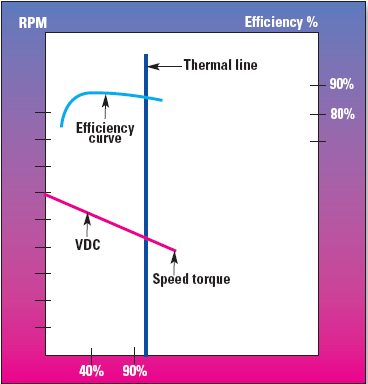

Efficiency is in the curve
For a given load, torque, and voltage on the motor, the speed-torque curve is used to determine operating speed. As the voltage is increased the speed-torque line goes up, increasing operating speed.
The thermal line shows the area at which the motor runs at its maximum design temperature of 155°C. If the motor operated continuously at any point to the left of this thermal line, it will operate cooler than 155°C. If it operates continuously to the right of the line, the motor will overheat.
The efficiency curve provides information on the servomotors’ input power versus delivered power over the operating range. Efficiency is easiest and most accurately obtained from testing, thus it is typically not provided by manufacturers.
Servomotors are designed to be highly efficient over a wide operating range, especially when operated within 40 to 90% of continuous stall torque. In one efficiency curve, for example, the servomotor attains more than 88% efficiency at 40% of torque. Efficiency remains high, and is 87.6% at 90% of continuous stall torque.
In general servomotors are designed to be over 85% efficient. The application, though, can alter this percentage.

Typical servomotor data with operating and thermal conditions. Servomotors arre designed to be highly efficient.
