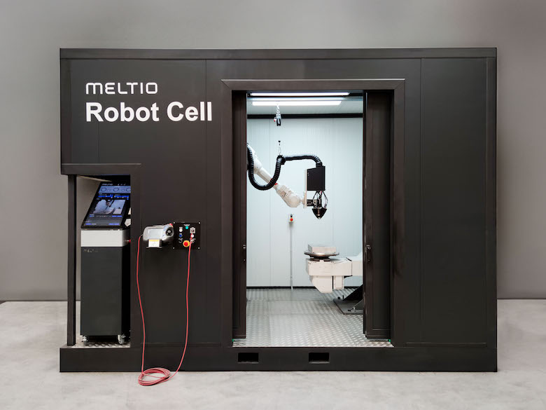

Meltio recently launched the Meltio Robot Cell, a turn-key metal additive manufacturing solution to boost industrial robotic arm performance in a safer, more reliable, and highly accurate way. The solution controls the entire process, including the recently launched slicing software, Meltio Space. This new system allows standard metal 3D printing starting from a build plate in a factory and part repair or feature addition.
Meltio Robot Cell is compatible with the open hardware platform that allows Meltio to integrate metal 3D printheads into any brand of robotic arm. The volume and work area defined in the workspace meet industrial-level needs and enable autonomous manufacturing due to its monitoring and safety features. The robot and positioner are installed on a self-supporting platform, laser-safe enclosure with Meltio Engine, Meltio Space, and accessories.
The plug-and-play system has a single electrical power supply and a single inert gas supply. The environmental conditions are standard, and this cell cannot be outdoors or unprotected from the sun and dust — it must be in a controlled environment. This solution allows the customer to receive a product ready to use for robotic metal 3D printing.
Meltio Robot Cell is certified and tested to operate with an ABB robotic arm as standard configuration. It is aimed at all industries and is an evolution of the Meltio Engine Robot Integration as a base production model to enable industries to incorporate 3D printed parts manufacturing with the Meltio head integrated into a robot into their production systems.

Meltio Robot Cell technical specifications:
- Easy to install, all included
- Turn-key solution
- Best-in-class components
- Safe, tested, and certified
- CLASS 1 laser product
- Meltio Space 1 (one) year subscription
- Large 3D printing volume with continuous positioner axes interpolation
- Standard CE certification. UCKA in UK and UL in America to be evaluated
- Steel platform with leveling points and wiring ducts
- All equipment and peripherals anchored on the platform
- All cell controls unified on single control panel
- Everything is sent integrated and tested
- The final reseller/integrator focuses work on training and enabling the client to manufacture parts
- Load an unload from truck with regular size and load forklift
- Includes 300 x 400 mm actively cooled build platform and build plates
- Single three-phase connector input
- All cell controls unified on single control panel:
- Connected to the customer’s local network (LAN) for PC interconnectivity
- ABB’s SafeMove to avoid collisions with enclosure
- Safe environment for the end customer
- Specific quality controls before and after integration, ensuring maximum performance at its final destination.
