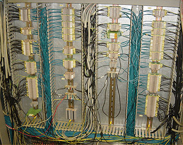

T&L Automatics, Inc. of Rochester, N.Y., experienced weekly shut downs from the control on its IMASFLEX seven-station dial index machining centers. Much of the downtime came from broken, loose, and shorted I/O wiring. The machine center makes precision-machined parts with complex features and intricate details for the automotive, aerospace, and defense industries.
To eliminate these shut downs, management choose Unique Automation, LLC (a Mitsubishi Distributor located near Rochester, NY), to replace the problematic CNC controllers and point to point wiring with a networked control system using Mitsubishi C64 CNC controllers, Q-Series automation controllers, and GOT operator interfaces, all tied together with the high-speed

A portion of the original central control panel shows some of the wiring that was eliminated.

With the CC-Link network, more than 25,000 feet of wiring was eliminated per machine. The network links the remote I/O stations to the Q-Series automation controller and GOT operator interfaces.
