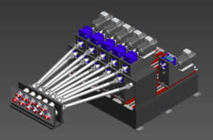

As its name implies, a roller leveler uses a series of offset, rotating cylinders to make coil steel flat. The material is fed into one end of the machine, which alternately bends the sheet in gradually decreasing “waves” that serve to reduce metallurgical stress and flatten the steel as it passes. In Delta Steel’s design, there are eleven rollers in all, five above the sheet and six below. Each roller is attached to a driveshaft, and each driveshaft connects to a gearbox driven by its own 150-hp motor.
Shown here is a CAD representation of the completed roller leveler drive assembly. Rollers are attached to each of the red couplings at the lower left.

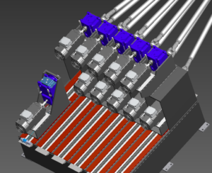

The problem with this particular project was twofold. As mentioned earlier, Delta Steel designers needed to stack the two rows of components one atop the other in order to fit everything into the limited space. This restricted access to the bottom row of drive components, though, so they developed a slide mechanism that would allow technicians to easily disconnect each gearbox and motor combination from the driveshaft and simply pull it back and out of the way for servicing.
Despite this space-saving arrangement, a compact but powerful gearbox would still be needed. For this, they reached out to their local NORD DRIVESYSTEMS representative, Steve Hunter, who put them in touch with application engineer Jeff Wittrock. He recommended an SK5207 series MAXXDRIVE Large Industrial Gear Unit in a parallel axis configuration and 14:1 drive ratio. With a UNICASE one-piece housing, symmetrical design, and extremely high power density for its size, the gearbox would provide plenty of torque along with the performance and service life needed for this demanding application.

“There were definitely some challenges,” Savariego said. “For example, if one of the bottom gearboxes were to be damaged, how would you access it without having to remove the ones above it? And even the best gearbox and motor needs routine maintenance, which would have been extremely difficult if we’d gone with a less flexible design. That’s what led us to the sliding mechanism I mentioned earlier, but that meant we had to minimize the driveshaft angle, which in turn required that we keep everything close together. NORD was quite helpful and willing to help us through the entire process until we reached the optimal design.”
A solution: simply disconnect the driveshaft from the front of the gearbox and pull the entire unit back for servicing.
