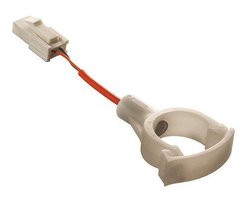

Dayton OH – Measurement Specialties manufactures pipe clamp temperature sensors which provide fast and accurate measurement of temperatures from -40° C to 105° C. Designed to fit 23.5 mm (industry standard ¾”) diameter pipe, the assembly consists of a thermistor which is mounted in a brass housing with a radius contact for optimum thermal response. An easily field-mounted clamp provides a tight fit to the pipe without the need for additional fastening. The thermistor is potted in a Delrin housing with epoxy resin, making it suitable for high humidity and high moisture environments — including refrigeration, central heating systems, gas combi boilers and domestic showers, as well as for use on solar collectors.
Typical response time in application is less than 3 seconds — models are available in a range of R/T curves. Tolerance at +25° C is 2%, though custom tolerances are available upon request.
These RoHS compliant Pipe Clamp Temperature Sensors have been developed as a solution for a wide range of demanding HVAC and Refrigeration applications. In addition to the standard units described here an don thei web site, www.meas-spec.com, Measurement Specialties can customize these versatile pipe clamp temperature sensors to suit any application in terms of tolerances, temperature ranges, response times, and electrical resistance.
