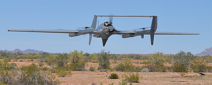

uav
Military and research agencies use the SeaHunter from Griffon Aerospace in Madison, Ala., for training, test, data collection, and system development. The UAV is powered by two DA150 electronic fuel-injected engines from HFE International. Each of these 150-cc boxer-style engines put out 9.9 kW and let the SeaHunter have a max take-off weight in the 250-300 lb range while also offering up to 2 kW of on-board electrical power for power-dependent payloads. The use of electronic fuel injection and special fuel pumps lets these engines work reliably at 10,000 ft.

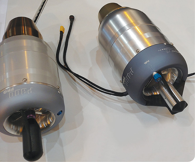

JetCat-Germany-engines
Jet engines like these examples from JetCat Germany can be found in drones, but only when there’s a need for speed that out-weighs the fact that such engines burn through a lot of fuel quickly. The record for the longest hoverboard flight was set with a hoverboard powered by four P400-pro engines, according to a JetCat spokesperson. The P400 develops 397 N of thrust at max speed while sucking in 1,300 ml/min of jet fuel. It weighs in at about 8 lb. The protrusion on the front of the engine (left) is a generator. The slightly larger P550-pro generates 550 N of thrust and weighs 10.8 lb.

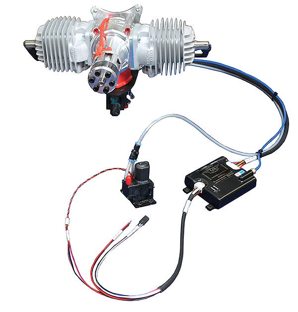

DA-120-EFI-engine-HFE-International
The DA 120 EFI (electronic fuel injected) engine from HFE International is an example of a hobby engine that has been re-engineered for use in more serious applications. The base block is from Desert Aircraft to which HFE adds electronic fuel injection and fuel pumps that provide more reliable operation, particularly at high altitudes. This re-engineered 121-cc engine puts out 8.7 kW (11.7 hp).
