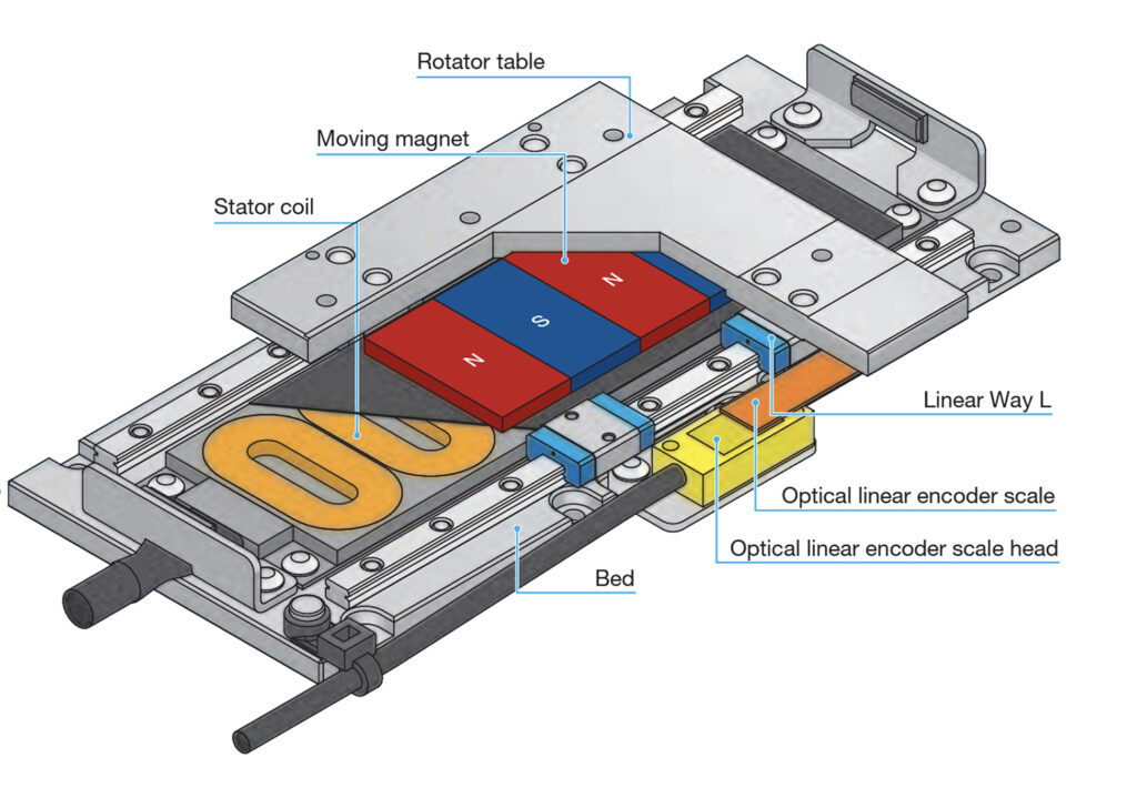

IKO graphicThe table is arranged to optimize positioning accuracy and response. Here’s how: The optical linear encoder scale is mounted on the moving table, and the optical linear encoder reading head is attached to the bed. This eliminates dragging cables that could impede motion, lead to wear, or generate unwanted particles that can otherwise contaminate a clean environment. The slide table has a very low mass, which enables faster acceleration and deceleration. In addition, the linear motor and high-resolution encoder can work in conjunction with an IKO linear bearing system or an IKO non-recirculating crossed roller way with an integrated rack and pinion gear set that combats cage creep.
The family comes in a variety of sizes, including units that are particularly suited for ultra-compact applications. For example, the smallest standard unit — the NT…V Series — is only 38 millimeters wide with an 11-millimeter sectional height and a 62-millimeter overall length that allows for a 10-millimeter stroke. To maximize thrust, two NT…V Series units can be arranged in parallel along with a single driver, which also minimizes table delay and flame torsion for stable attitude and positioning accuracy at a lower cost than a two-axis synchronization system. Axis configuration options include horizontal, vertical with spring balance, X-Y, or an integrated Y-Z axis. Additionally, single-axis tables can be combined to achieve custom multi-axis solutions.
