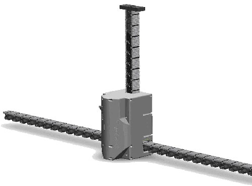

SERAPID introduces a non-magnetic telescopic linear actuator. The RigiBelt telescopic linear actuator is made of two reinforced plastic belts that interlock together much like a zipper to form a rigid telescopic column. It moves quickly while telescoping in and out and can provide either horizontal or vertical motion.
RigiBelt SD (Standard Drive) is an off-the-shelf actuator, self-contained, and is driven by a 24V DC motor, and is currently available for sale.

If the SD does not suit your needs, SERAPID will work with you to co-develop a solution to meet your specific application with the RigiBelt Rigid Chain actuator.

SERAPID’s complete line of telescopic linear actuators is well suited for use in a variety of industries: medical, pharmaceutical, aerospace, architectural and industrial to name a few. These actuators are entirely mechanical, which makes them environmentally friendly and suitable for clean-room conditions.
