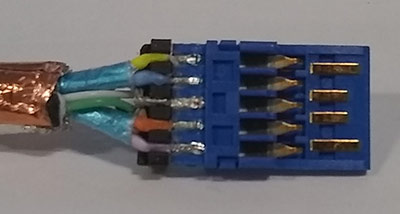

Figure 1. USB 3.0 connector terminations. The image above shows a good termination. The foil shield is held tight against the wires until it is very close to the blue insulator. Conversely, the foil shield on the bottom connector is cut back about 1/3-in
The primary specification that the connector impacts is the differential impedance. Controlling the impedance requires a constant cross-section for the critical signals. This is easy to achieve in a cable, as the cross-section remains mostly constant throughout the entire cable. It is much more difficult through the connector because the cross-section is continually changing: The signals travel from wires, to solder pads, then to connector pins. Each of these regions has a different cross-section, and thus a different impedance. It is for this reason that the specification allows a larger impedance range through a connector than through a cable (90Ω ± 15Ω for the connector versus 90Ω ± 7Ω for the cable).
The main area which causes the impedance to fail specification is the signal wires near the connector pads. In this area, the foil around the twisted pairs is removed in order to connect the wires to the solder pads. Since the foil is used to control the impedance of the wires, its removal causes the impedance to spike. For this reason, it is critical to minimize the length of foil shield that is removed.
Omnetics-USB-BadIn Figure 1, the top connector shows a good termination. The foil shield is held tight against the wires until it is very close to the blue insulator. Conversely, the foil shield on the bottom connector is cut back about 1/3-in. The difference between these two connectors is likely the difference between passing and failing the impedance specification.

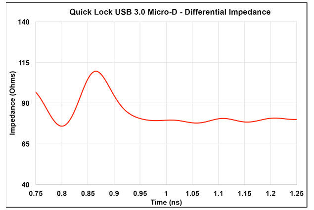

Figure 2. Differential impedance of Omnetics Quick Lock USB 3.0 connector

One solution on the market that is meeting these requirements is the Omnetics Quick Lock USB 3.0. Advanced techniques are used to maintain tight control over the manufacturing process. These new techniques enable the pair shields to be kept tight to the wires all the way up to the solder pads, which is necessary to ensure a good impedance through the connector (See Figure 2).

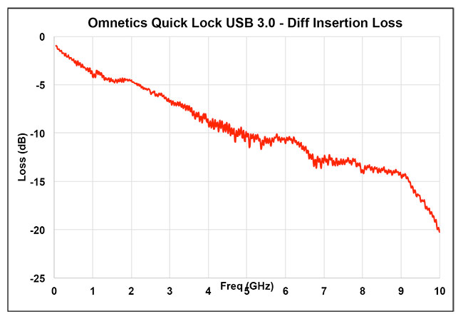

Figure 3. Differential insertion loss for 2-meter Omnetics Quick Lock USB 3.0 cnnector assembly
The proper cable was determined through a lengthy process that involved countless cable iterations. As mentioned earlier, finding a cable that provides less than 15 ps/m of intra-pair skew is not trivial. Our final cable yielded an intra-pair skew of around 12 ps/m.
High-performance insulation material was used to maximize the insertion loss. Figure 3 shows the insertion loss of a 2-m assembly, which meets the loss requirements for USB 3.0.
