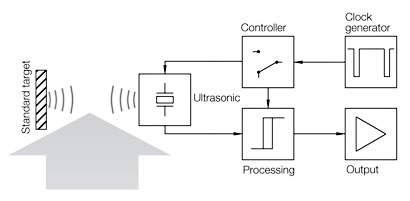

A typical ultrasonic sensor comprises a clock (signal) generator and a controller to excite the transducer, then a processor and output amplifier to handle the return signal.
Due to their use of sound waves, ultrasonic sensors also perform well in dusty, dirty environments. However, they do not operate well with small targets against large backgrounds or targets such as foam batting that are excellent for absorbing sound waves.
