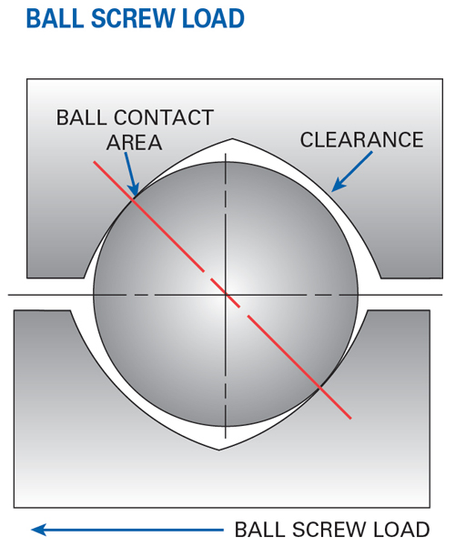

Another critical factor to consider is how well the device can handle the required loading conditions, including the higher dynamic loads that occur within the small spaces required for many types of instrumentation. You need to assess a range of different loading scenarios, particularly when today’s applications require smaller and smaller ball screw assemblies.
Consider static loads (will the thrust applied to the ball nut damage the assembly?) as well as dynamic loads associated with travel of the nut along the screw, linear and rotational speeds, acceleration and cycle rates, and the drive torque involved. Make sure that the ball screw won’t succumb to tension loads by stretching, or compression loads that squeeze the shaft. Are there side or overturning loads that are part of the mix and need to be evaluated? Is a preloaded ball screw assembly—a ball screw that is preloaded with an internal force between the ball nut and screw assembly to eliminate axial and radial lash—required for a specific application? With many precise medical manufacturing processes, you may need to control assembly stiffness to maximize positioning and stability control in the servo drive control system. Is the ball screw assembly stiff enough for a particular application?
Developing a detailed load profile for the ball screw per its use in a device or mechanism will let you avoid costly missteps and select the appropriate ball screw assembly for your particular application.

That’s not to say that there are not possible problems with ball screws to consider. One potential issue that designers should watch out for is backlash. Backlash relates to the degree of axial and radial motion or play between the screw and nut when the ball screw is not moving. Preloading the ball screw with an internal force between the ball nut and screw assembly can eliminate axial and radial lash.
