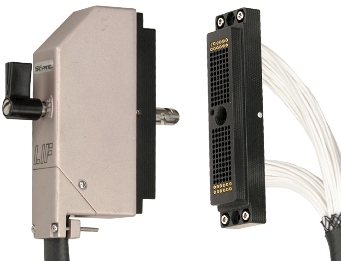

LIF panel connectors
LIF connectors are available in a variety of formats. LIF panel connectors can support a range of connectivity applications including high-density I/O. They are locked into place with a half-turn twist and can include multiple signal, power, and RF contacts with 260 or more I/Os per connector (Figure 2). These LIF connectors use hyperboloid pin and socket contacts that offer improved performance compared with simple paddle spring contact designs. The RF contacts are rated for 2 GHz and the power contacts for up to 23 A.
