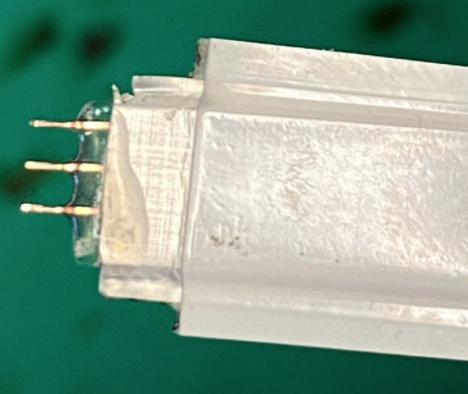

There’s also an increasing demand for flat or rectangular conductors to support the 56 and 112G per-lane copper, differential-paired applications in smaller form-factor equipment.
It’s likely such products will be used for the next generation of internal, video-standard interfaces and applications. Rather than FFC and FPC connectors and cables, they’ll likely require advanced flat and ribboned cables. This is because flat cable conductors usually terminate with greater ease and reliability to flat PCB pads, at least in terms of signal integrity.
In fact, flat RF wire 75 and 50ohm options are already available. A better insertion loss is achievable than with standard round-coax wire at the same thickness. Currently, oval, ovoid, ellipse, knurl, and other conductor geometry designs are also being evaluated for specific applications.

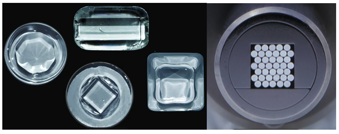

Newer silicon-shaped fiber cores are also now available in rectangular, square, octagonal, and hexagonal shapes (and more), providing more options and excellent coupling efficiencies. Armadillo SIA in Riga, Latvia is one supplier of these unique fiber-core geometries. Typically, round cladding is used with silica cores, so the fiber can work with round ferrules and standard optical connectors.
Armadillo also offers tapered fiber solutions and non-round fibers in singular cables that support many advanced applications. They usually use fluorinated silica cladding that conforms to the fused, non-circular core, mimicking its optical properties. Their angular fiber cores work well with diode laser devices.
