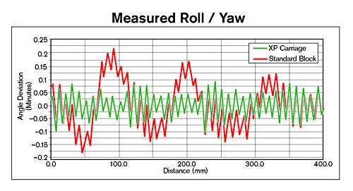

Enhancements to the ball raceways result in 60% less deviation as the high-precision runner block travels along the rail.

An example of a system that has altered its geometry is the Ball Rail® system.  To insure smooth motion as the balls circulate in the bearing raceways, the system uses a steel insert and relief zones that dampen the ball entry forces at the ends of the bearing. This configuration eliminates the rough motion and rolling of the ball rail system about its axis and creates accurate height and width dimensions as well as reliable linear motion about all axes. Our tests show a 60% reduction in pitch, roll, and yaw compared to standard linear guide systems.
