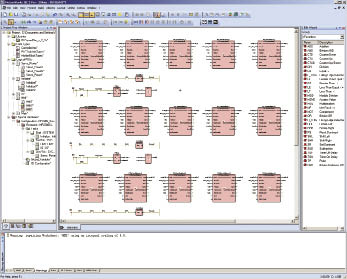

52 Axes of automated test equipment.

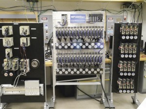

At the very beginning of a new product’s life, we develop a strategy of what its features will be and how best to test those features. Initially, the outcome of these strategy sessions was to produce plans and documents that relied heavily on manual testing, as we didn’t have the luxury of automated test. The tools and technology of the time led us to use written scripts that were printed out and executed by test engineers or, more likely, product or development engineers.
Multiple controllers configured with all supported modules.

The production testing phase ensures that each piece of hardware will perform satisfactorily over the life cycle of the product; that each piece of software or firmware will complete its task as required, no matter how many new features are added; and that any new feature will act as designed and not interfere with any existing element. In most cases, additional features are added through software or firmware updates.
Thus, each production test will need to be executed hundreds or thousands of times without deviation over several years. Applying this concept manually is time consuming, expensive and mundane. Because testers perform the same steps numerous times and execute the tests on many different platforms or varying hardware, boredom sets in.
Thus, testers will execute manual tests in a slightly different manner each time, providing conflicting outcomes. Automated testing provides timely, cost effective, and consistent results.
With automated testing, the test cases are maintained in a database and run by a computer. The test suite can usually be started overnight and run without supervision. Results can be viewed the next morning. There is almost no overhead associated with running the test suite. This allows testing to be run more often without consuming precious team resources.
Developers are informed of any defects as soon as the tests conclude, allowing them to correct problems quickly. This constant cycle of code development followed by testing allows the entire development team to be more productive, and improves morale among team members.
As long as the main script is not altered, the test can be performed in many iterations without any change to how the basic test is conducted. This eliminates mundane repetitive tasks that are prone to human error. The test will be run exactly the same way every time, so it will be easy to catch any deviation in performance, or any corruption of existing features that a new version may introduce. Vigorous testing is the only way to create the high quality product demanded by the end users, systems integrators and OEMs that develop factory automation systems. Without automation—testing can be monotonous, time consuming, costly and error prone.
