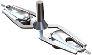

In conventional zinc die casting, a sprue bushing is incorporated into a die to direct the molten zinc from the machine through a runner and gating system and finally into the die cavities. This full “runner system” is then ejected, and the parts are separated. The remaining scrap runner system is then either remelted or sold.
This is an example of a sprue and runner in a conventional runner system. The hot runner system will eliminate most of this processing scrap.

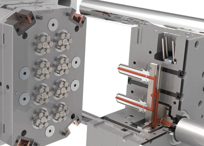

The sprue and main runner system are eliminated when using a hot runner system. Depending on the size and shape of the components being cast, molten zinc can be either directly injected into a casting or indirectly into a small sub-runner that feeds molten zinc into a single or multiple cavities.

Eliminating the sprue and runner system also allows for improvements in casting efficiency. The space that was used for the sprue and runner can now be used to make more parts in a shorter amount of time.
Shown here is the Ferrofacta hot runner system with an indirect runner eliminating the conventional sprue and runner system.

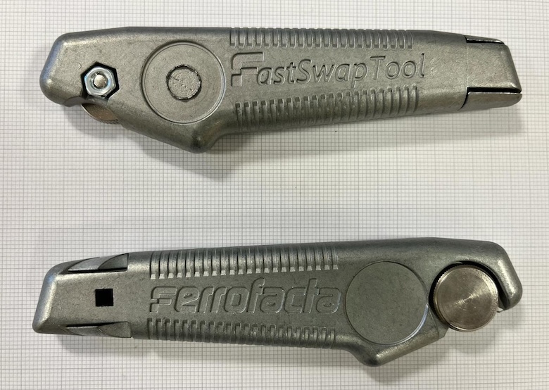

Shown here is the Ferrofacta Knife sample.
The Ferrofacta knife is a sample piece that is given away at tradeshows. The tooling and hot runner system was designed to showcase the different methods of gating — direct or indirect gating — and their advantages.

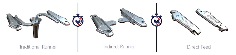

The direct gating option is where liquid zinc is fed directly onto the surface of a part, resulting in the complete elimination of a scrap runner system. There are also no residual traces of gate marks or overflows on the split line. However, a remnant of the gate remains on the casting surface, which may be acceptable for functional castings, or can be covered by a cap or secondary process. This gating option is used more often for medium to larger casting sizes.
The indirect gating option is where liquid zinc is fed into a small sub-runner before filling cavities. The main advantage of this option is to allow for multiple cavities per nozzle, and is far more economical, especially for smaller castings.
This compares a traditional sprue and runner (left) to the indirect (center) and direct (right) gating options for the hot runner systems.
