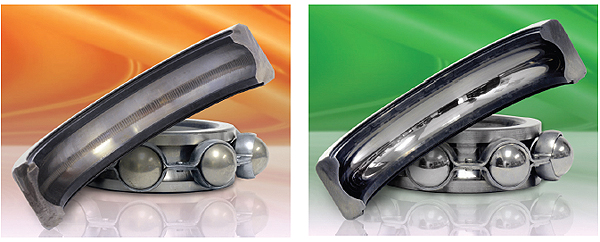

Without some form of mitigation, shaft currents discharge through bearings, causing unwanted electrical discharge machining (“EDMing”) that erodes the bearings and race walls [Figure 1] and leads to premature bearing/motor failure. Before long, these frequent discharges can leave the entire bearing race riddled with pits known as frosting [Figure 2]. In fact, electrical damage has become the most common cause of bearing failure in VFD-controlled AC motors.
new-bearing-race-wall
[Figure 1] Viewed under a scanning electron microscope, a new bearing race wall is a relatively smooth surface, marked by nothing but mechanical wear where bearings contact the wall.
Pitting-of-a-bearing-race-wall
[Figure 2] Pitting of a bearing race wall (magnified).
In a phenomenon called fluting [Figure 3], the operational frequency of the VFD causes concentrated pitting at regular intervals along the race wall, forming washboard-like ridges. Fluting can cause excessive noise and vibration, which, in an HVAC system, can be magnified and transmitted by ductwork throughout the entire building. By the time this is noticeable, bearing failure is often imminent.
fluted-bearing-race-wall
[Figure 3] Taken from a failed motor, the “fluted” bearing race wall (left) resulted from VFD-induced bearing currents. Protected by an AEGIS® SGR Bearing Protection Ring, the race on the right is undamaged.

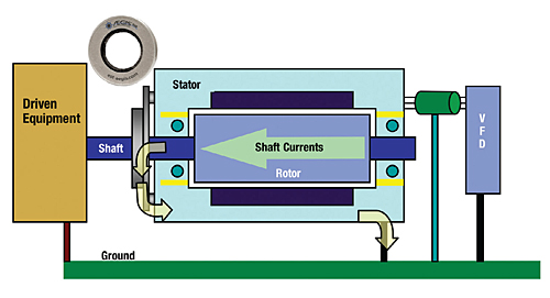

circulating-currents-diagram
[Figure 4] For motors above 100 hp, both circulating currents and common mode voltages can cause bearing damage. Combining an insulated bearing on one end with a shaft grounding ring on the opposite end provides the best protection from electrical bearing damage.

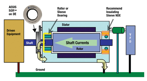

• For motors up to 100 hp, where common mode voltages could cause bearing damage, adding a shaft grounding ring to the motor, either inside the motor or externally, provides effective protection against bearing currents for motor bearings as well as attached equipment [Figure 5].
circulating-currents-diagram-2
[Figure 5] For motors up to 100 hp, where common mode voltages could cause bearing damage, adding a shaft grounding ring to the motor, either inside the motor or externally, provides effective protection against bearing currents for motor bearings as well as attached equipment.

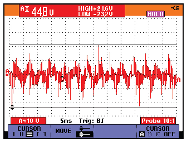

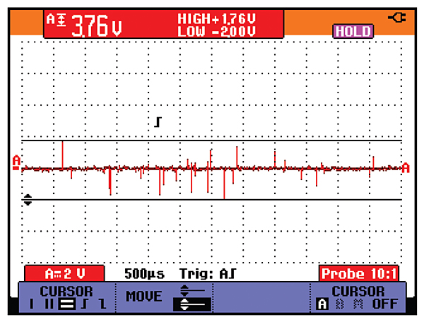

motor-shaft-currents-graph
[Figure 6] Measured with an oscilloscope, motor shaft currents before (top) and after (bottom) installation of the AEGIS® SGR Bearing Protection Ring on a motor in an HVAC unit.
