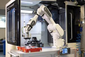

Powered by ABB’s OmniCore C90XT controller, the SWIFTI CRB 1300 is up to five times more precise than any cobot in its class, making it suitable for tasks requiring consistent accuracy and repeatability. This, combined with a top speed of 6.2m/s, and payload options from 7 kg to 11 kg and reaches from 0.9 to 1.4, enables the SWIFTI CRB 1300 to perform a range of higher payload tasks including screwdriving, assembly, pick-and-place, and palletizing. With protection against dust and moisture (up to IP67), it can also be used in demanding environments, making it suitable for machine-tending applications.

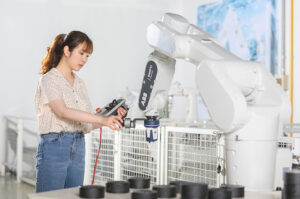

The same simplicity applies to programming the SWIFT CRB 1300. Users can set up the robot by either physically guiding it through a process (lead-through programming), or through ABB’s new Wizard Easy Programming software. Based on simple graphical blocks, Wizard Easy Programming makes programming accessible for non-specialists in robotics.
