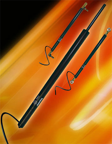

Model CR Rod & Cylinder sensor integrates a standard Model CS or CM sensor inside a steel mechanical package, protecting the sensor electronics from mechanical and environmental damage. The sensor withstands shock and vibration up to 5g.
Containing an internal, non-contact, piston-mounted magnet on a rod that extends and retracts to measure motion, the package features a 1 mm thick housing, stiff 12.5 mm rod, and is IP67-rated. It is available in two analog models, a 5 Vdc supply ratiometric output version and 12 Vdc supply reference voltage output version, both of which feature a pulse width modulated (PWM) output.
Linearity is +/- 0.3 mm, repeatability of +/- 25 microns, and a 2.6 kHz update rate. It comes in six standard lengths along the 250 mm active stroke range: 72.3 mm, 109.3 mm, 148 mm, 186.3 mm, 217.3 mm, and 250.1 mm.
