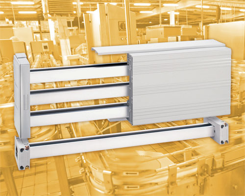

Pentair Equipment Protection introduces the Hoffman 60-mm Busbar System, delivering a direct mounting solution for reliable, safe power distribution. Components are mounted onto pre-wired adapters that snap onto sliding DIN rails, reducing raceway and bending radius space to enable close proximity placement with fewer wiring errors, less assembly labor and more connection flexibility.
Engineered for power and scalability, the 60-mm Busbar System can distribute three-phase power over 1,600 amps at 690 volts, along with supplying single phase or DC power. The system can be cut into lengths fitting most electrical enclosures, with vertical and horizontal positioning for space optimization. The busbar system’s input and output terminals accommodate wire sizes up to 600MCM, with far less drilling or tapping required. For additional modularity, components, such as fuseholders, switches and circuit breakers, can be added to the busbar structure to meet growing application demands.
To comply with industry standards, the busbar system is touch-safe rated to IP20, UL508 listed, CSA certified and CE compliant, making it ideal for demanding automation and control applications in a wide range of industries, including automotive, wastewater, material handling, packaging, food and beverage and parts assembly.
