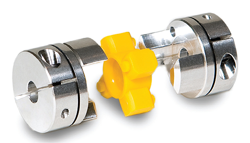

Zero-backlash jaw couplings
Similar to the oldham coupling, the jaw coupling is also a three piece design comprised of two aluminium hubs and an elastic element called the “spider.” Made of an advanced polyurethane material, the spider dampens impulse loads, minimizing shock to the servomotor and other sensitive equipment. Available in three durometers, the spider lets you tailor the performance of the jaw coupling, such as torsional stiffness, misalignment, and dampening requirements. Metric and inch hubs (set screw, clamp style, keyed, or keyless) are interchangeable and can be combined into a single coupling.
jaw-coupling
Similar to the oldham coupling, the jaw coupling is also a three piece design comprised of two aluminium hubs and an elastic element called the “spider.” The curved jaw profile concentrates the forces to the center of the spider ’s limbs, improving the effectiveness of the elastomer material.
Jaw couplings have a curved profile hub that press fits onto the spider assuring zero-backlash. The curved jaw profile concentrates the forces to the center of the spider’s limbs, improving the effectiveness of the elastomer material. Raised contact points on the spider limbs help maintain proper spacing between the two hubs, assuring electrical isolation and full angular misalignment capabilities. Jaw couplings are considered failsafe because the jaws of the two hubs interlock for direct power transmission if the spider was to fail, allowing the application to be safely shut down for maintenance.
