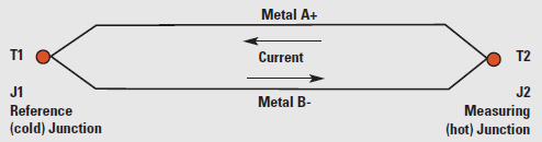

When two wires of different metals are connected at two junctions and the measuring junction is exposed to a higher temperature than the colder reference junction, current flows in the series circuit. This phenomenon is called the Seebeck effect, discovered by T. Seebeck in 1821. When the reference junction is opened, the voltage that appears across the open ends is a function of the sensing junction temperature. Its polarity and magnitude depend on the materials used to form the thermocouple.
When two dissimilar metal wires are connected at junctions J1 and J2 and the Measuring junction J2 is exposed to higher temperature than the reference junction J1, current flows in the closed circuit. This phenomenon is called the Seebeck Effect.

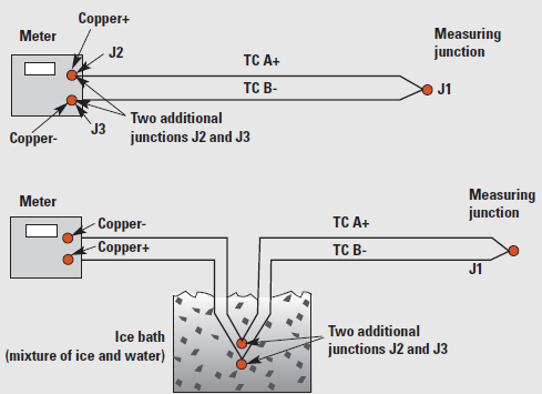

Thermocouples cannot be connected to just any type of instrument terminal. For example, when a thermocouple is connected to copper input terminals of a meter, two new thermocouple junctions are created. Additional cold or reference junctions produce additional voltages in series that can add to or subtract from the voltage produced by the measuring junction and significantly reduce accuracy.
To achieve reasonable accuracy, an ice bath can be used to keep the temperature of the two additional junctions stable at 0ºC regardless of the ambient temperature. Because the two junction temperatures are constant and the same, the voltages produced by the additional junctions are also constant and can be easily compensated in the meter. However, handling ice baths are a bother and modern instruments use an electronic circuit to replace the ice bath for cold junction compensation.
Connecting thermocouple wires to copper leads or terminals of an instrument creates two additional cold junctions, J2 and J3. They produce additional voltages that vary depending on the ambient temperature of the meter. An ice bath keeps these two junctions at a stable 0° C and holds thevoltages constant, which is easy to compensate within the instrument.

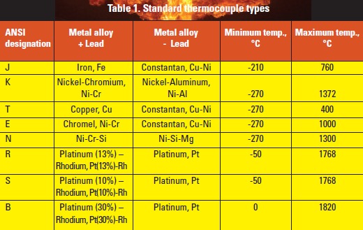

Different types of thermocouples use various combinations of several metals resulting in a wide range of sensitivies, linearities, temperature ranges, and corrosion resistances.
The temperature extremes and environment to which the bare thermocouple (TC) wires will be exposed are the starting points in the type selection. For example, the most commonly used J-type is recommended for reducing atmospheres and operates between -270 and 760ºC.
Another widely used general-purpose TC, type, K, has an operating temperature range of -270 to 1,372ºC, but is recommended only for clean oxidizing atmospheres. Many digital thermometers and multimeters with built-in thermometers are supplied with K-type thermocouples.

Recommended for sub-zero temperature measurements due to its moisture resistance is the T-type thermocouple that spans -270 to 400ºC. It is compatible with oxidizing and reducing atmospheres. The E-type has a range of -270 to 1,000ºC and the highest EMF output compared to other standard thermocouples. It has a high resistance to corrosion at low temperatures and can be used in oxidizing, reducing, and all inert atmospheres.
These thermocouple types belong to what is called the base-metal group. They are inexpensive and widely available. A second major group of thermocouples is called the noble-metal group (platinum alloy). Noble-metal thermocouples are more expensive than base-metal types and have the highest corrosion, and oxidation resistance, and temperature limits.
Accuracy varies among the different thermocouple types. For example, the standard tolerance for J and K types is ± 0.75% or ±2.2°C. R and S types have a tolerance of ± 0.25% or ±1.5°C. The tolerance is defined as the deviation from an ideal thermocouple, not the degree of nonlinearity.

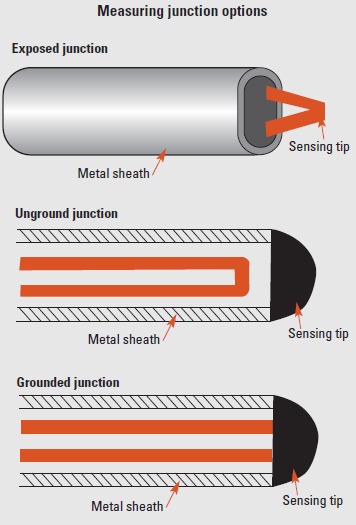

Sheath covered thermocouples can have an exposed, ungrounded, or grounded measuring junction. The junction selection depends on the environment and mechanical impact the junction will be subjected to. The exposed junction has the fastest response of all types, but is the least protected from the environment. Another advantage is its relatively small mass in contact with the measured object. This minimizes the heat sinking effect that could temporarily lower the temperature of a small object during the test.
Thermocouple types with exposed junctions are not usually isolated electrically from the metering circuit. If the thermometer shares a common lead or electrical potential with the circuit being measured, touching  a live circuit with the exposed thermocouple can create a short.
thermocouple types 3
The exposed thermocouple junction has the fastest time response, but it is susceptible to mechanical damage and corrosion. Totally enclosed ungrounded and grounded thermocouple junctions are well protected from the environment, but they have slower response times than the exposed junction.
The grounded thermocouple junction also can be a potential safety hazard. The thermocouple and insulator are completely sealed and protected from the atmosphere, but the junction is welded to the sheath from the inside. It provides a path for a ground return circuit through the sheath, which can be a shock hazard. This type provides a faster thermal response than the ungrounded type, but it is much slower than the exposed type with the same sheath diameter.
The ungrounded junction has the best thermocouple protection of all types, including electrical isolation. However, it is also the slowest.

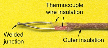

Simple thermocouple types can be constructed in-house by combining either bare or insulated thermocouple wires and bonding them at the measuring end. The wires can be welded, soldered, silver soldered, or twisted to make a measurement junction.
Twisting thermocouple wires is the easiest method and does not require any special tools, but it produces the least reliable connection. Since the wires are not actually bonded together, corrosion or vibration can interrupt the electrical contact over time. Twisting can also lead to acquiring erroneous temperature readings. Several turns are required to get a secure junction, so the first point where the two wires touch is a certain distance away from the point of measurement. As a result, a surface measurement reading can be different from the actual temperature because the measuring junction is not in contact with the surface. A twisted thermocouple is usually satisfactory for liquid or air measurements where the whole twisted area is submerged.
Soldering or brazing techniques limit the operating temperature range to the melting temperature of the solder. Care should be taken to make a firm mechanical connection between the thermocouple wires. If the solder holding the wires together separates the thermocouple wires from each other the junction will not be formed even though electrically the circuit will be complete.
Welding is the preferred way of assembly, but producing a good welded thermocouple tip without proper equipment is not easy. A poor weld can produce an open circuit connection. Overheating the welded connection can change the operating characteristics of the thermocouple metals. For these reasons, commercially available thermocouple junctions are bonded on special capacitive discharge welders where energy and weld temperature are closely controlled.
