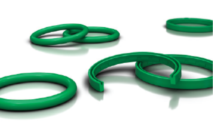

Trelleborg’s new sealing solutions address hydrogen production, transport, storage, and end-use challenges. Image courtesy of Trelleborg.
Designed to accelerate innovation for sustainable technology, H2Pro has solutions for the challenges of hydrogen production, transport and storage, and end-use. Proven to withstand challenging application environments, the materials are suitable for high pressures, low temperatures, and resist permeation, making them better able to withstand rapid gas decompression while also demonstrating excellent wear and extrusion properties.
