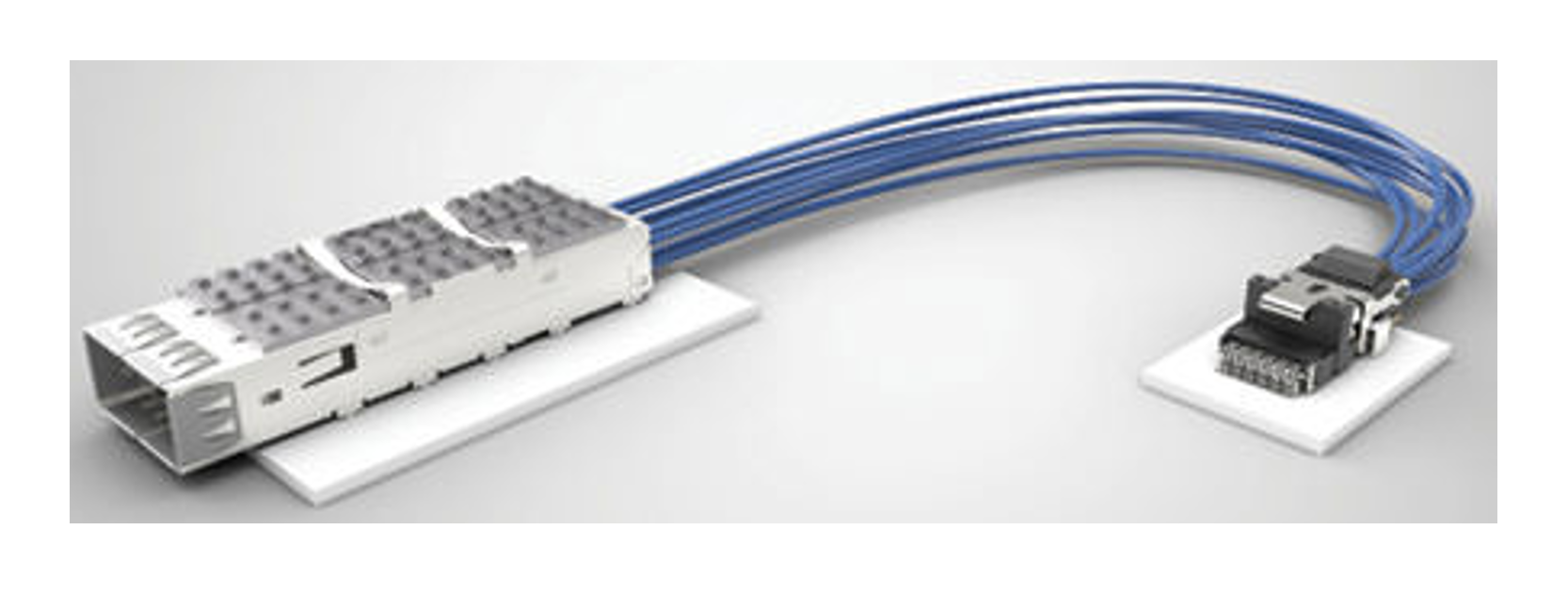

Let’s consider the current internal server faceplate to network chip interconnect implementations. Below is an example of a singular, older generation pluggable receptacle connector and internal cable.

Here’s an example of the DualLine ASIC cable assembly.
