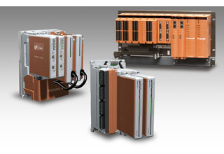

Yokogawa Electric Corporation announces that it will be releasing an enhanced version of the ProSafe®-RS safety instrumented system (SIS) on November 27. This new version, R4.01, features an exciting expansion of Yokogawa’s lineup of I/O devices and introduces crucial new SIS components. In addition, the FieldMate™ Validator software has been enhanced to work with this latest version of ProSafe-RS.

- N-IO (Network I/O) field I/O device with smart configurable I/O that can handle multiple types of I/O signals
SISs rely on field I/O devices for the transfer of data to and from sensors, valves, and other types of field instruments. Using this data, they can detect abnormal conditions and safely initiate emergency shutdowns. Depending on the instrument model, the type of electric signal used to transfer this data varies. With a conventional FIO device, a compatible I/O module is needed for each signal type.
The N-IO field I/O device developed for use with ProSafe-RS fulfills the functions of smart configurable I/O, enabling software marshalling and flexible I/O assignment. It has an I/O module that accommodates multiple I/O signal types and allows configuration of an individual signal type for each point. Both analog and digital I/O signals, which account for the majority of I/O signal traffic, can be handled solely through software settings. With the N-IO, it is no longer necessary to replace the I/O module, reducing the amount of rewiring that must be done when changing sensor types and/or layouts during a plant revamp. This significantly reduces the amount of work that has to be performed by plant engineers and maintenance personnel. The N-IO device can also be used together with conventional FIO devices.
In addition, Yokogawa has signed OEM agreements with Pepperl+Fuchs GmbH*1 and MTL Instruments Group Limited*2 under which Yokogawa will receive baseplates and market them as its own products. These will be used in combination with the company’s N-IO modules and intrinsic safety (IS) isolators procured from the two companies. Both partners have solid track records in the development of interface products for use in hazardous areas. This tie-up means Yokogawa is able to ensure that the N-IO conforms to the major IS regulations in Europe, Asia, and the Americas.
