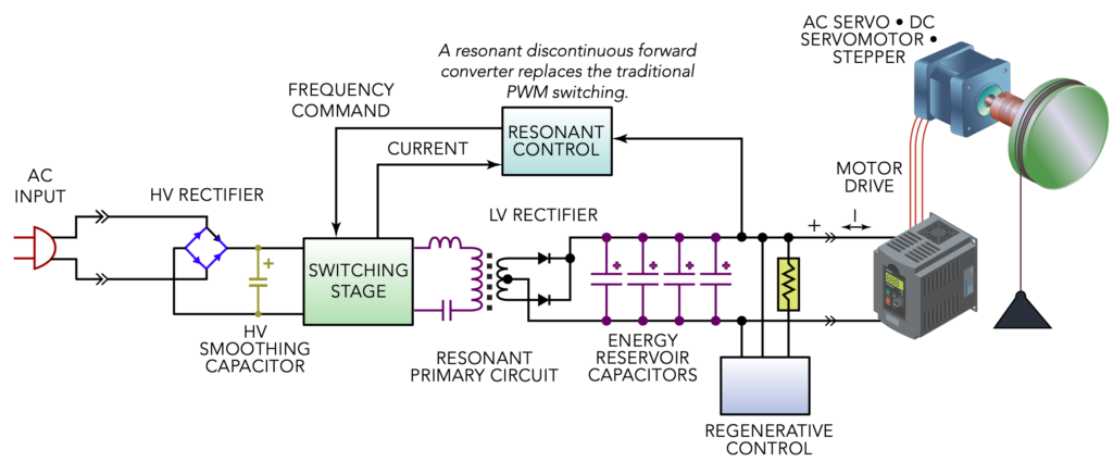

In contrast with linear power supplies are switched power supplies — our focus here. These convert input ac to a higher-frequency supply (to many kHz) using rectifier and (for ac outputs) inverter electronics. Then they quickly switch power between the load and onboard inductors and capacitors. Voltage conversion is via a transformer that (because of the high frequencies involved) can be quite compact.
Diode-only rectifiers let current pass in solely one direction … so convert ac power (with continually varying direction) into dc power with current held in that one direction. The catch is that such simple devices sans other electronics can generate output exhibiting problematic fluctuations.
