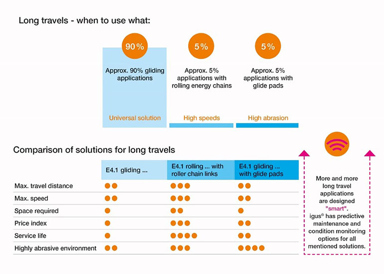

The energy supply system has an undercut design and thus a high torsional rigidity. It is quiet and variable in heights and widths. In 90% of gliding applications, the E4.1 is the universal solution. To extend the service life of the energy chain, especially in abrasive environments, igus has now introduced glide pads with which the chain can be easily upgraded. The wear-optimized sliding elements can be easily placed on the chain links in the inner radius. They are made of a highly abrasion-resistant igumid polymer, which can double the service life of the energy supply system at travel speeds of 1-3m/s.

igus has had energy chain links with rollers in its product range for over 20 years. They reduce the pull/push forces on long travels and ensure a significantly longer service life of the energy supply system. The company has now developed optimized roller chain links in two sizes especially for its E4.1 modular system.
Click to enlarge.
Their use is particularly worthwhile at high speeds of up to 10m/s or very long travels. The rollers reduce the drive power by up to 37%, which significantly saves energy. The new roller chain links and glide pads provide a customized energy supply system for every special application from 12 m to 500 m travel.
