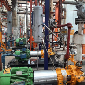

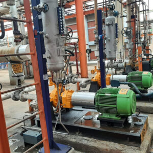

Sulzer engineers developed the OHX pump retrofit kit to offer the latest API specifications to any brand of OH2 pump while delivering overall performance improvements without replacing the casing or making any changes to the connecting pipework. Only the affected parts can be upgraded, which is more cost-effective than replacing the whole pump.
A new case cover with API 682 seal chamber meets latest API 610 standards, including the double mechanical seal. In addition, the bearings are upgraded to a longer life component, extending the expected service life from 25’000 hours to 50’000 hours. This improvement also includes upgraded oil guards, which offer much better oil sealing compared to the components of the 1970s.
The retrofit kit also introduces a cooling fan and an improved coupling and guard. The former helps to reduce bearing temperatures, extending their service life, while the latter meets the latest occupational safety and health administration (OSHA) requirements.
