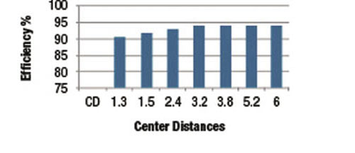

Generally speaking, right-angle worm gear reducers begin to see drops in efficiency as they cross into higher ratios. Larger center distance worm gearboxes are generally more efficient than smaller center distances. For example, a standard unit with a 2.6-in. center distance sees efficiency decrease slowly as ratio increases.
Similarly, as center distance grows, efficiency improves, as seen here where the rise in efficiency for seven center distances is at a 10:1 ratio.

Right-angle worm gear reducers tend to lose efficiency as they cross into higher ratios. Larger center distance worm gearboxes are generally more efficient than smaller center distances. For a standard unit with a 2.6-in. center distance, for example, efficiency decreases slowly as ratio increases.

As center distance grows, efficiency improves, as seen here where the rise in efficiency for seven center distances is at a 10:1 ratio.
