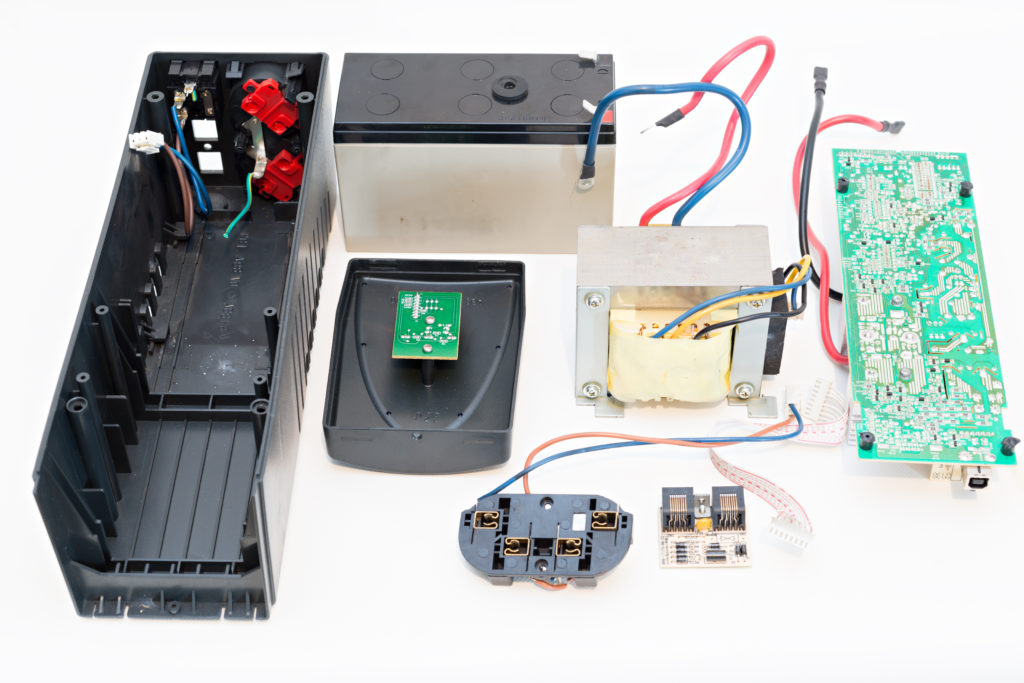

Although the name UPS is widely accepted as referring to a UPS system, a UPS is one component in a UPS system — albeit the main component. The whole system includes:
• The electronics that detect power losses and switch active output to draw from the battery
• The battery (whether lead acid or other) that provides the backup power
• Battery charger electronics that charge the battery.
Shown here is an all-in-one uninterrupted power supply or UPS with battery, charge electronics, charge-control electronics, and output receptacle.
UPS systems are supplied by manufacturers as all-in-one fully housed (and turnkey) components; UPS electronics and charger integrated into one product, but the battery sold separately; and totally separate UPS, battery, and battery-charger products. Fully integrated all-in-one components are most common in IT settings. UPS systems with UPS and charger electronics sans battery are most common in industrial settings such as factory floors. The third and least popular configuration is based on separately supplied UPS, battery, and battery charger.
